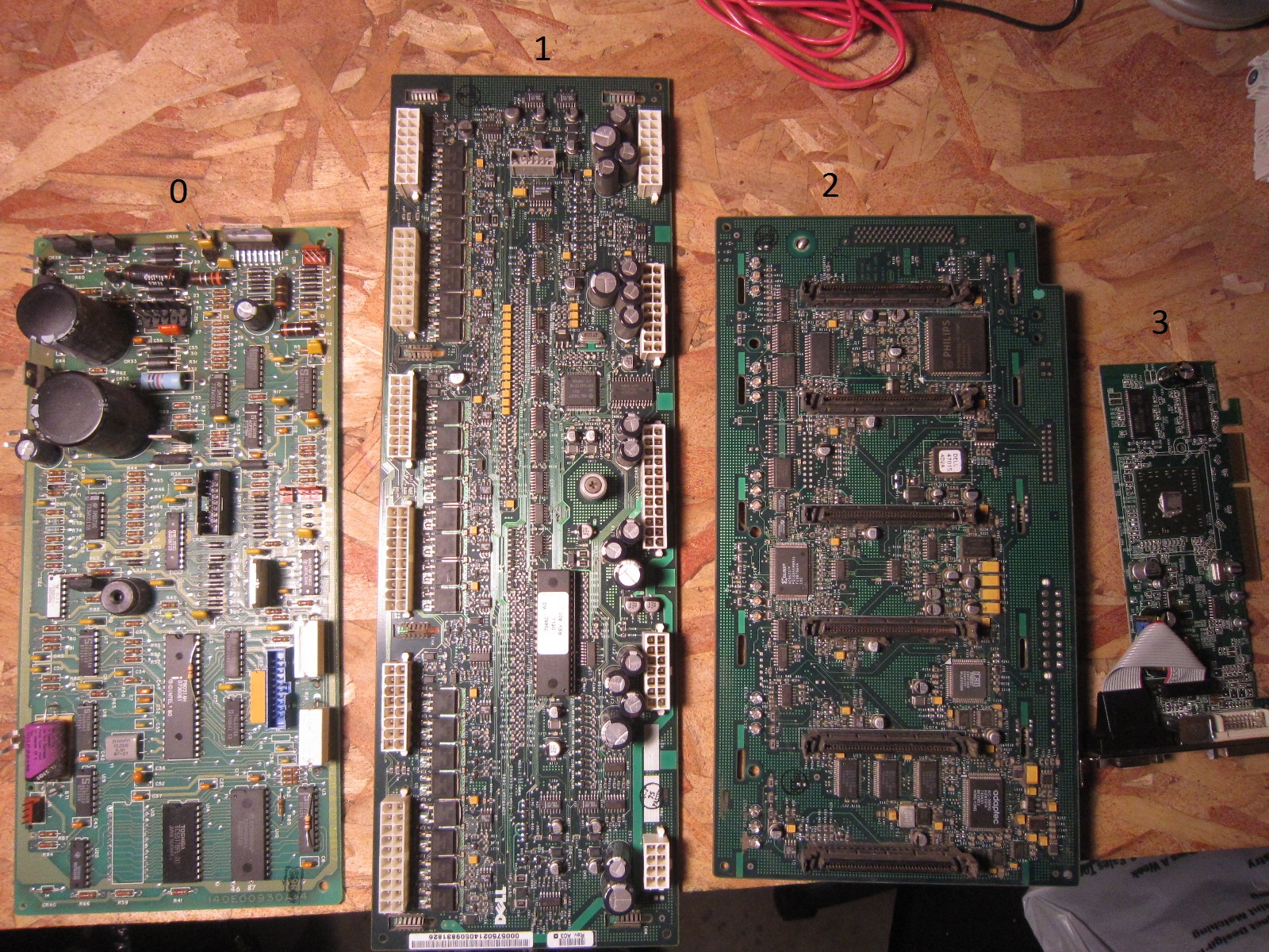

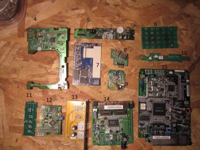

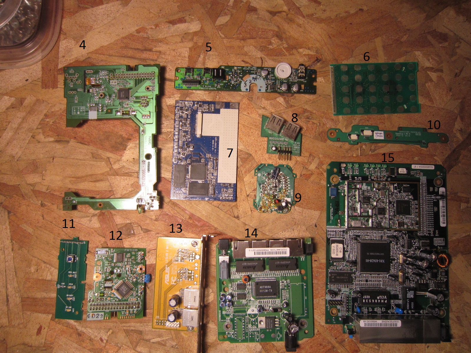

Sorry still trying to learn how to sort. I would appreciate help checking against what I think they are. Also any protips of what to remove. Thanks!
0 - mid grade
1 - ?peripheral?
2 - ?peripheral?
3 - gold finger card

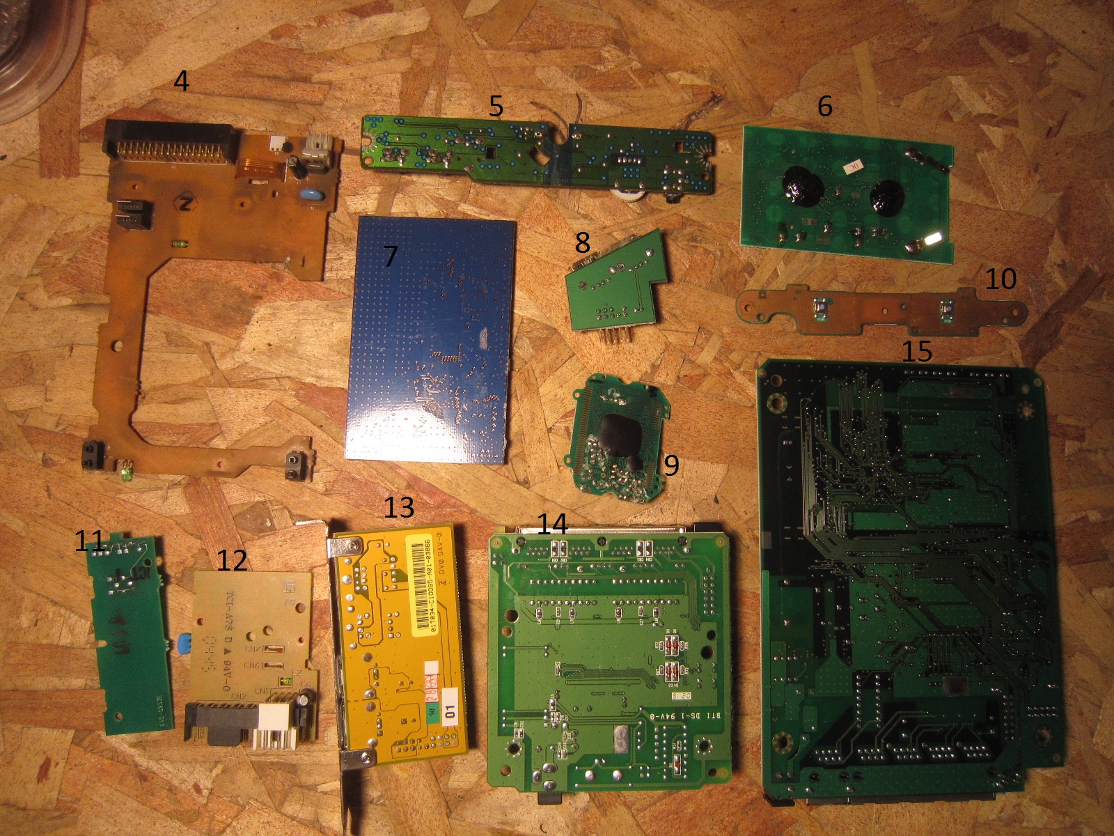

4 - peripheral
5 - mid
6 - mid
7 - peripheral
8 - ?mid?
9 - ?mid?
10- mid
11- mid
12- ?peripheral?
13- peripheral
14- peripheral
15- telecom (router)

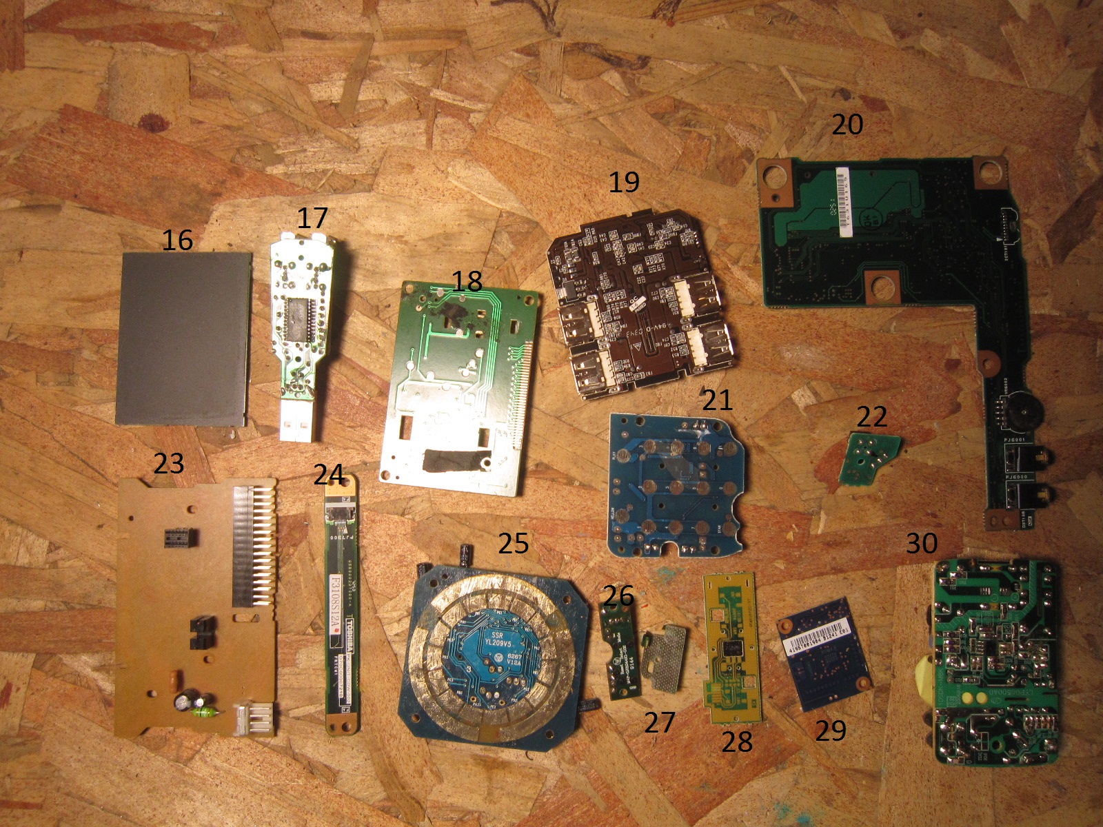

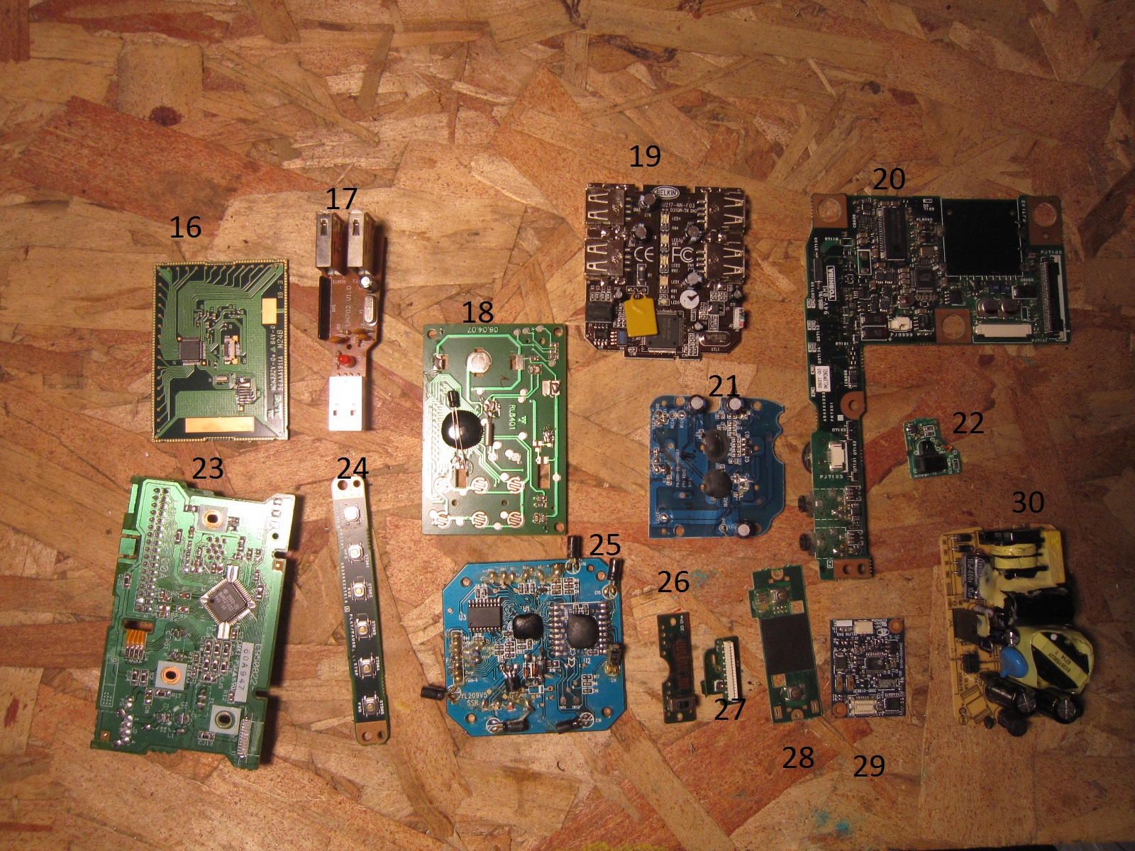

16- ?mid? (mousepad)
17- low
18- mid
19- peripheral
20- peripheral
21- mid
22- mid
23- ?peripheral?
24- mid
25- peripheral
26- mid
27- mid
28- mid
29- peripheral
30- low

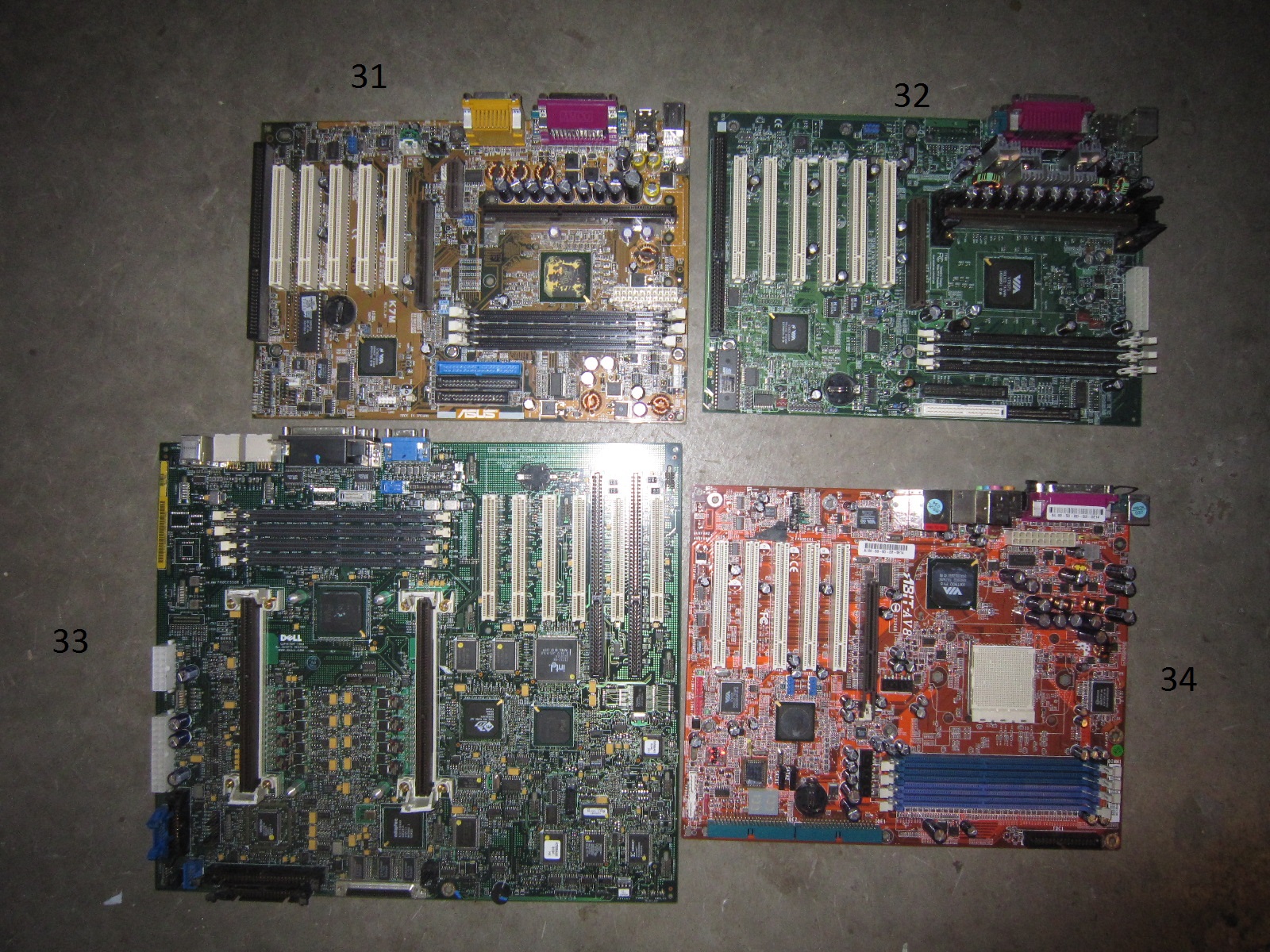

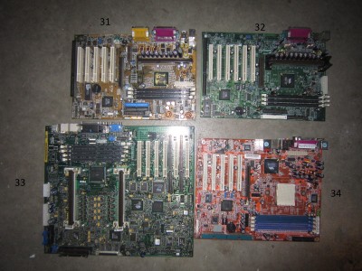

31- large socket
32- large socket
33- dual large socket server
34- ?large socked? (1 5/8" pin to pin)
PostPosted: Mon Apr 21, 2014 10:39 am
Posts: 378
Everything looks correct except:
0 = Peripheral
1 = Telecom
2 = Backplane
I cannot see 15 good enough (I will need to see the other side of the board).
30 = Midgrade
Thanks for the look!
PostPosted: Thu Apr 24, 2014 1:16 pm
Posts: 378
Correction, 30 is Low Grade and 15 is in fact Telecom. (I accidently skipped over the front view picture the first time through).
The reason 30 is lowgrade is because of the brown side and lack of any gold content be it pins or plating.
Sorry about the revision.
