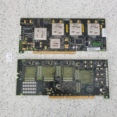

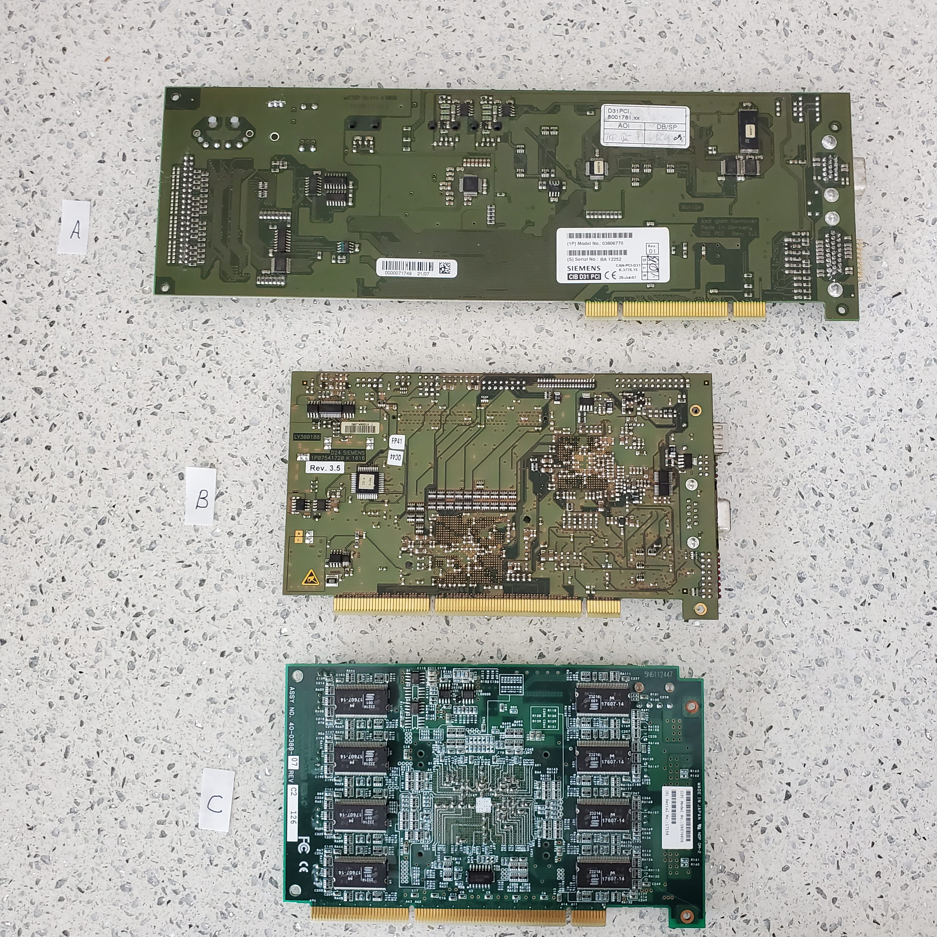

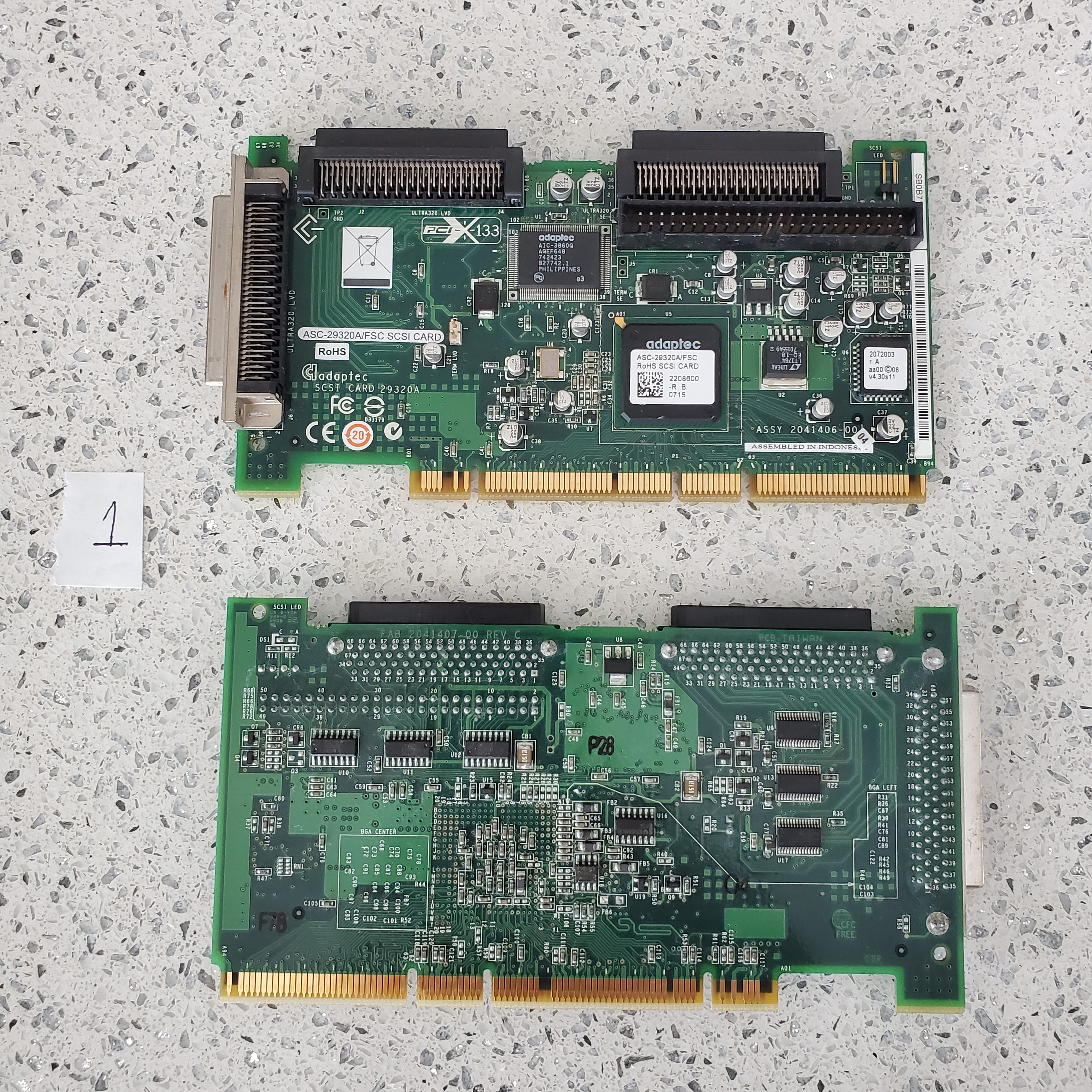

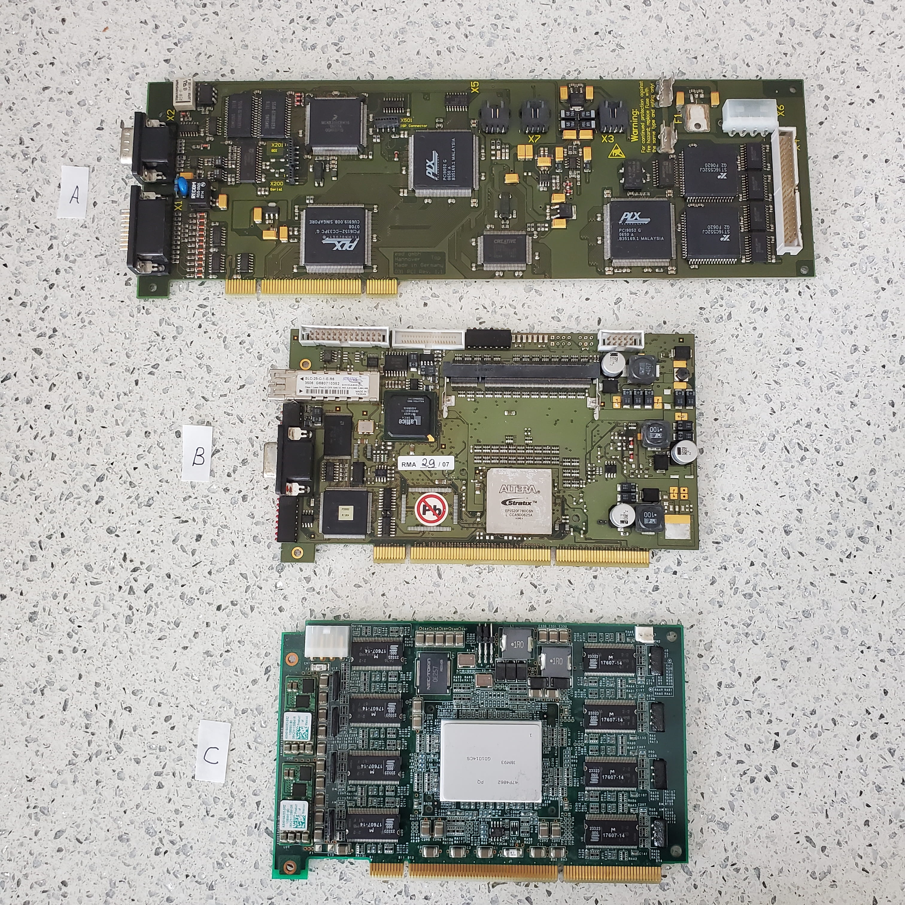

Hi I'm new to e scrapping and need lots of help how would I grade these boards
Thank you in advance for all the advice

Thank you for your reply As far as spare the frustration I thought that was the purpose of this forum is to learn
Before Oscar shut down Oscar graded number 4 as telecom high-grade
Hoping to get A better understanding of the e scrap I have
PostPosted: Fri Feb 06, 2026 6:07 pm
Posts: 1715
2,4,a,c are all borderline for me. Any of them might be good enough for high telco but I'm not certain enough to commit to that.
Definitely a spot to learn; Catwhisker is fairly new to the scrap stuff too and has other expertise that I hope he keeps sharing. But I echo his assessment that I would probably put all these in clean GFC if I was sorting them myself.
