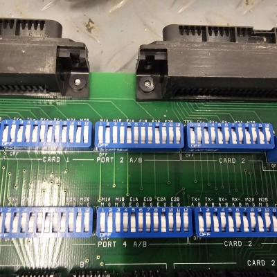

What should this go with. Going to have a small batch of these
Tough to see in pics but all are gold connections.

are you saying the little switches have gold balls? (cause some of those style switches do)
I'm torn, I want to say high peripheral but it's kinda bare besides the pins (unless the switches have something) so may dip down to low peripheral.
PostPosted: Sat Jan 17, 2026 12:02 am
Posts: 740
