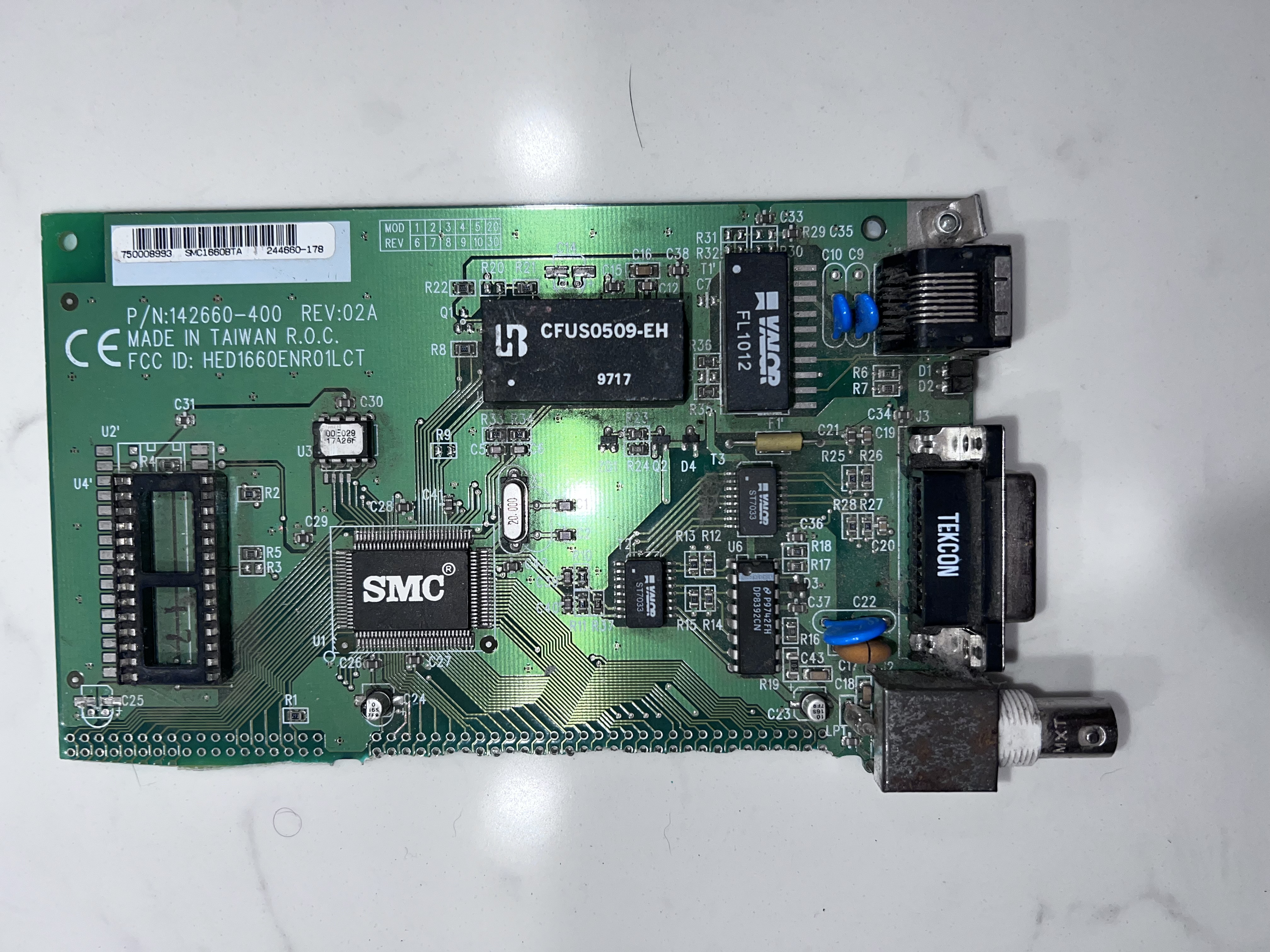

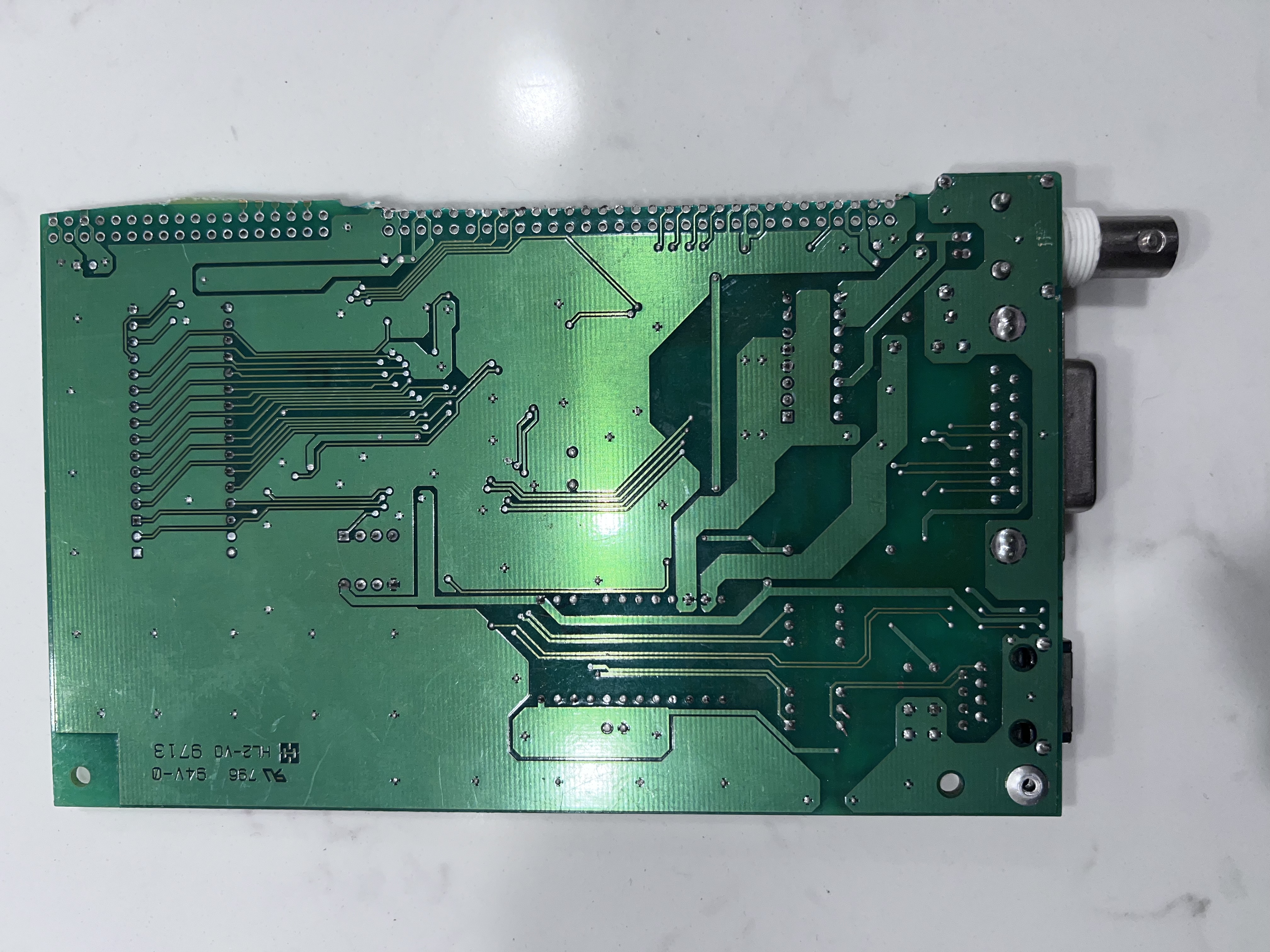

Board A - Big Tantalum yellows, but thinking still high peripheral. Take off non soldered connector? Would it make a difference?

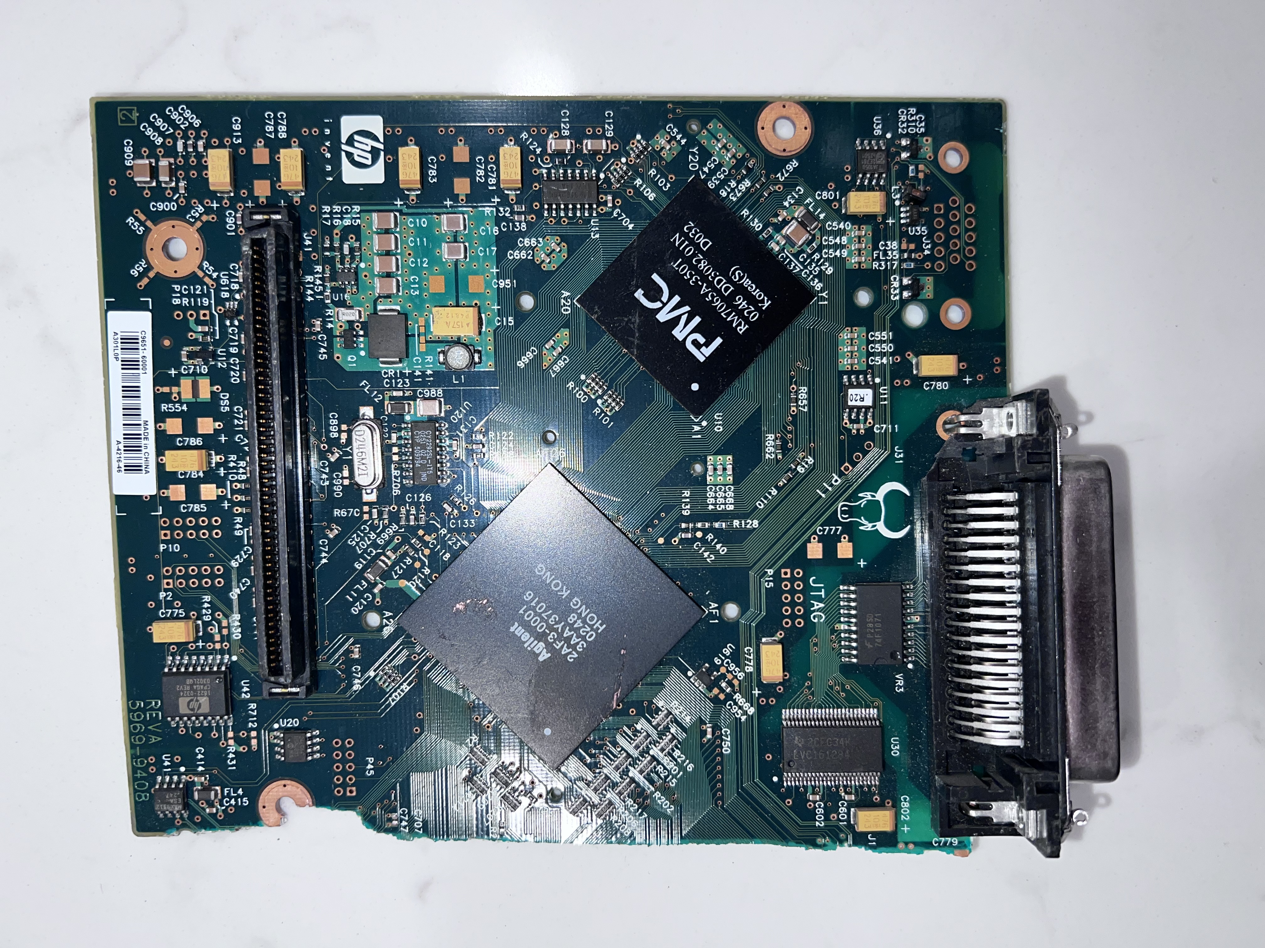

Board B - Looks like gold fingers cut off, and an older unit. Initial thought was trimmed card, but now thinking high telecom because of the size of the IC's on small board & gold veins throughout.

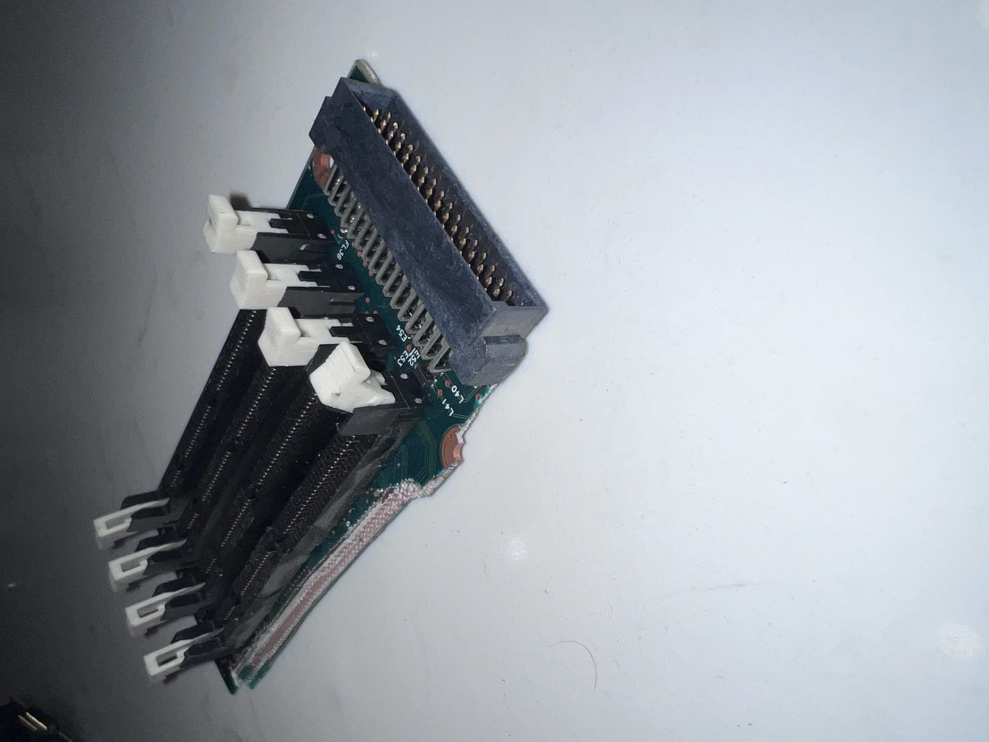

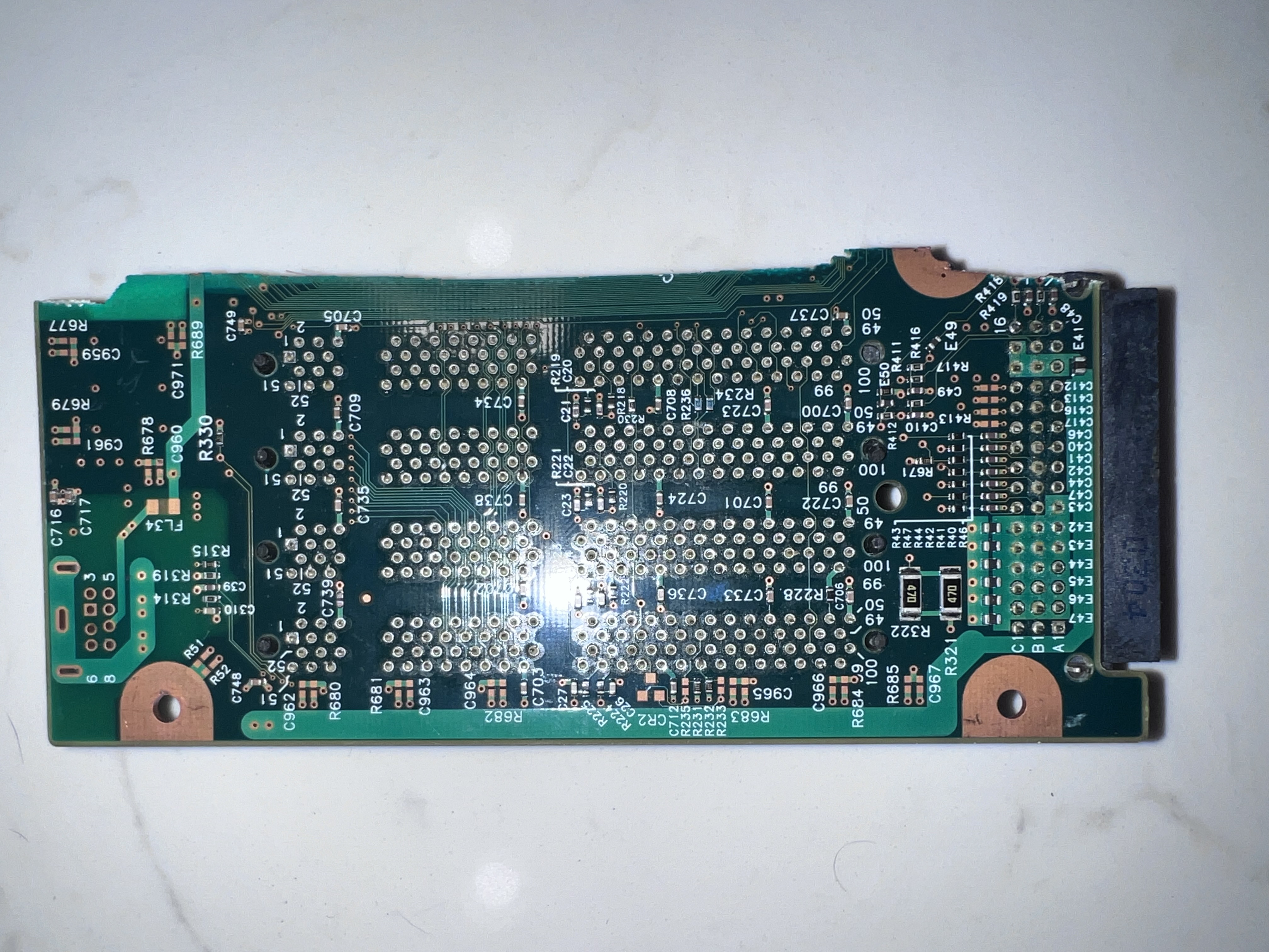

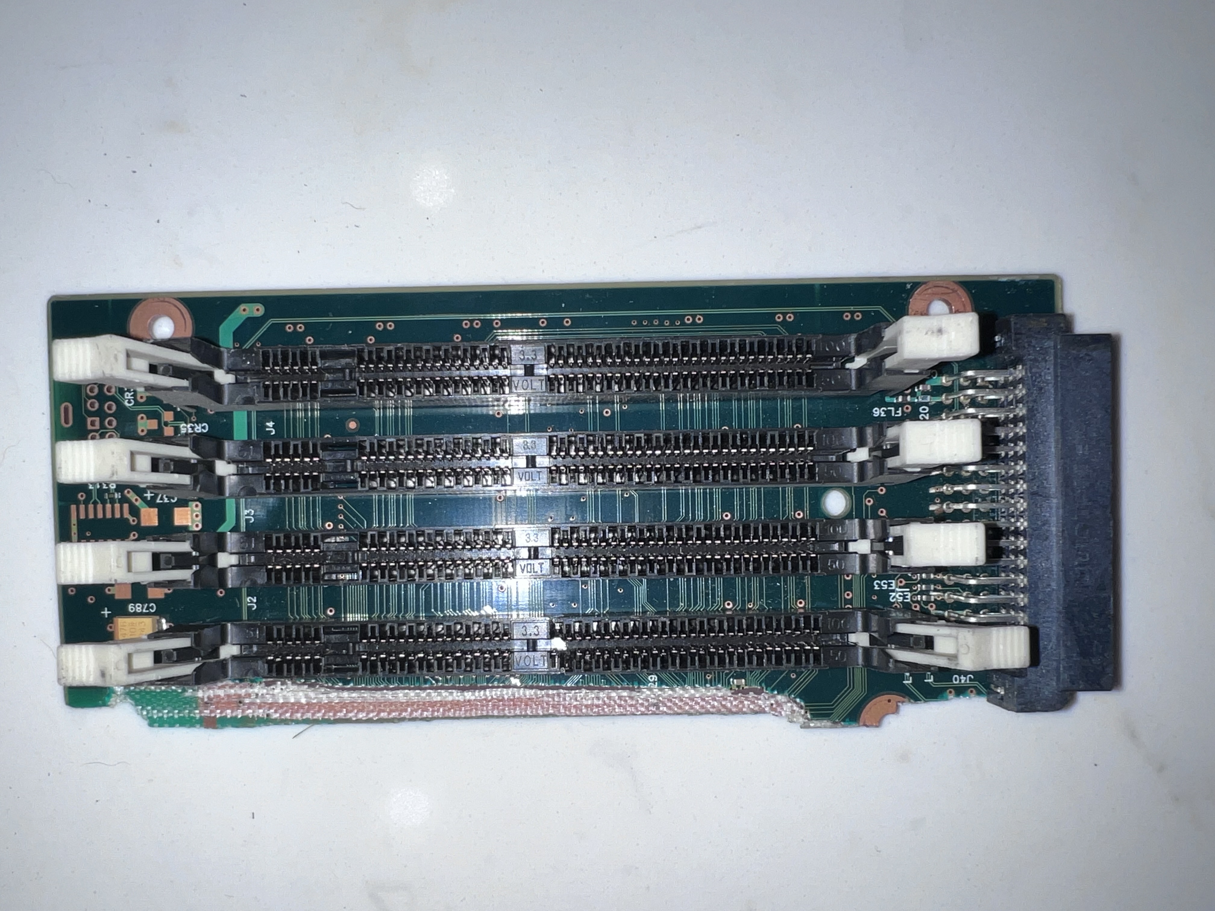

Board C - my initial thought is backplane. Do I need to take the big connector off? Pins look like are partial gold plated mil spec

Looks like all three boards have had their gold fingers removed. I'm not sure how much that affects the classification. I've seen some people post to remove the gold fingers on certain boards and others not.
If there were mine and only had those 3 I would toss them in the Peripheral High Grade pile and hope for the best. If you have a large pile of boards you might want to contact Boardsort first before sending them and getting downgraded to Mid.

A will clear as high peripheral
B is low trimmed gold finger card by BoardSort standards (be happy id pay much much less!)
C is a trimmed riser card. My best guess is low peripheral.
