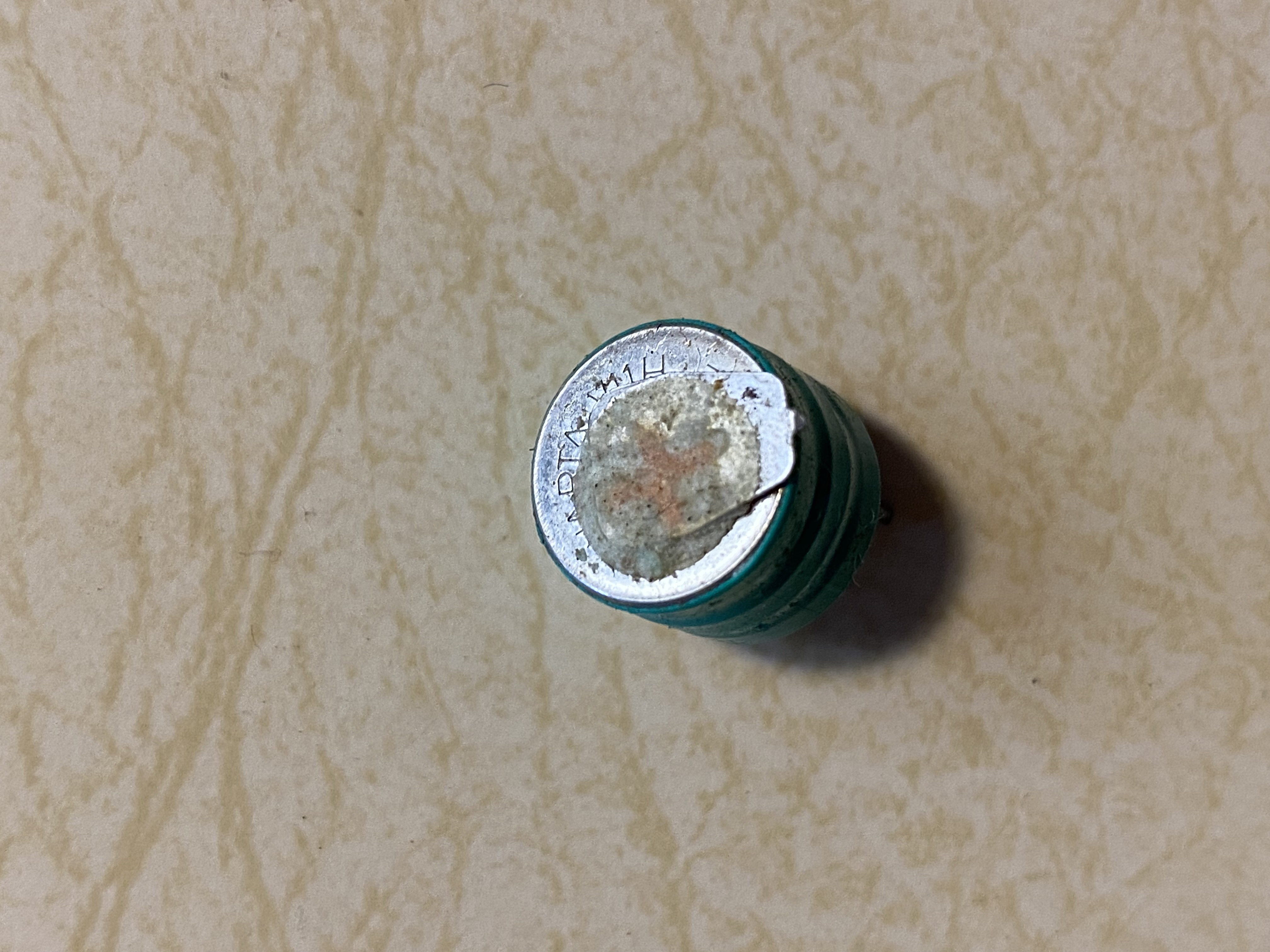

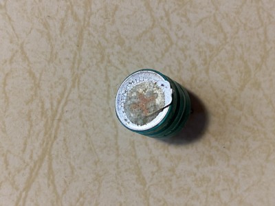

File comment: Unknown (Varta?) a
File comment: Unknown (Varta?) b

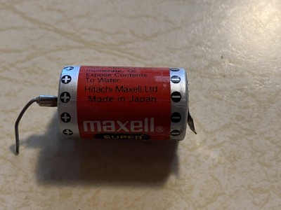

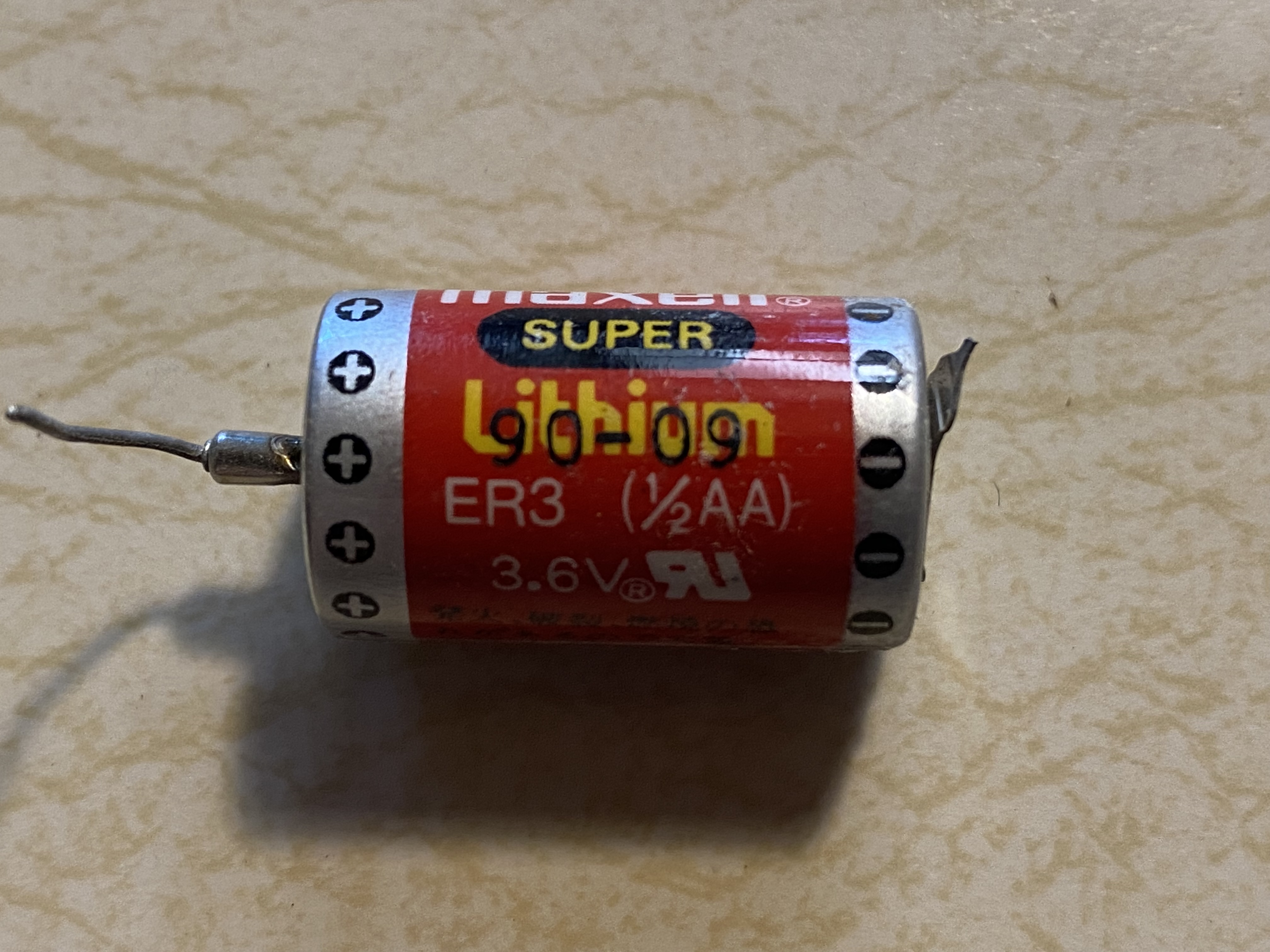

File comment: Maxwell Lithium a
File comment: Maxwell Lithium b

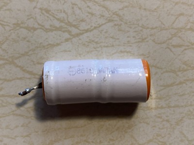

File comment: Unknown Japanese (no identifiers under white shrinkwrap)

The second and third photo are pancake stacks. Button cell batteries soldered together
A nice selection of canister cells.
The white one is probably Mitsubishi.

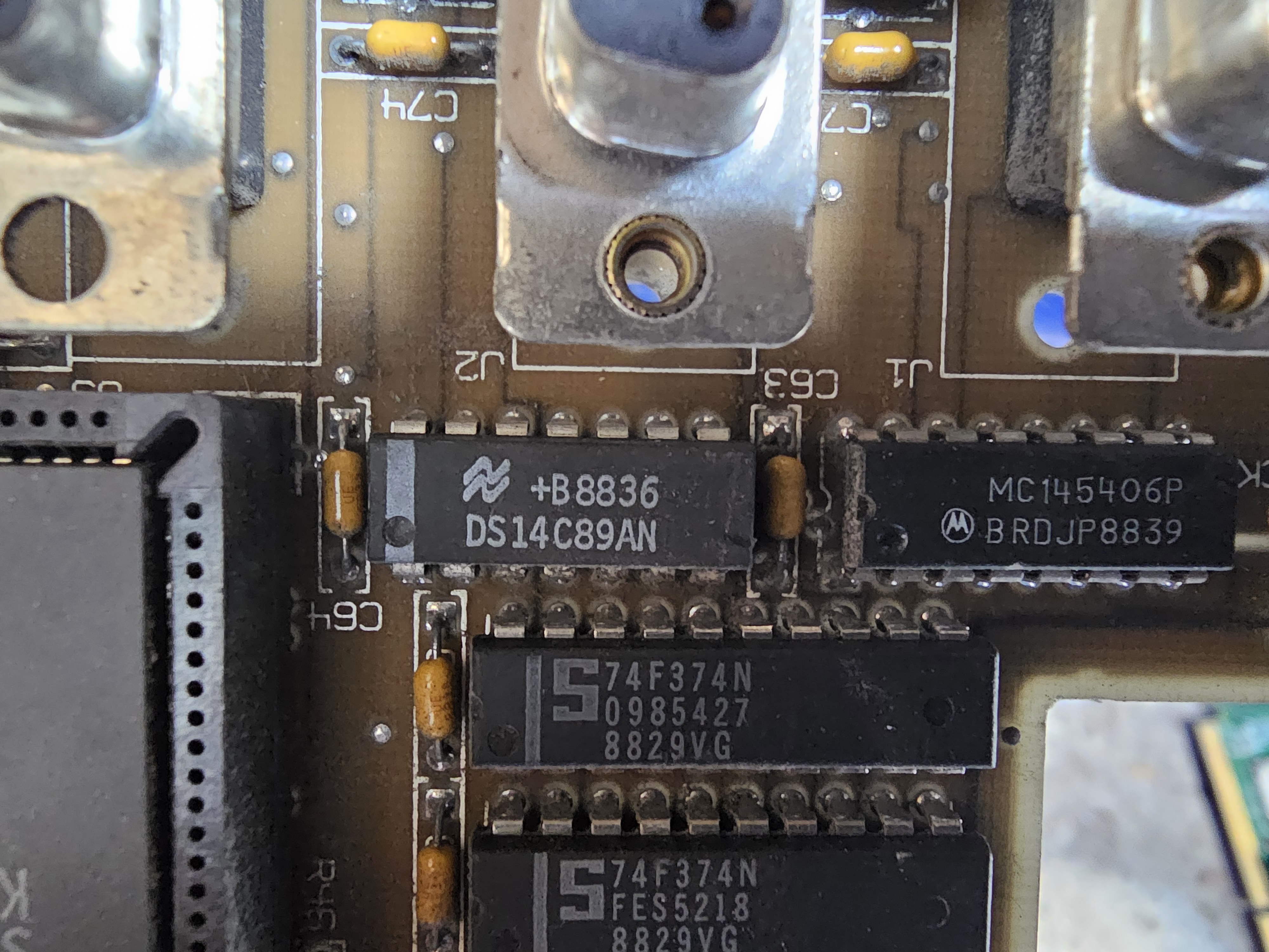

I want to be sure these are not dallas switches. Can I get help to verify
PostPosted: Wed May 01, 2024 9:57 pm
Posts: 10108
Nope! All ICs
