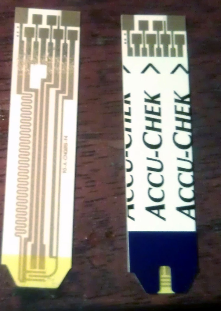

I have tried acetone, bleach, goof off, alcohol, soap and nothing takes the goopy glue that holds the two sides together. that would need removed before trying too extract the traces from the other side...see photo

I do have a process for the same strips you show. I do take my time when doing this and that could be why it works for me.
1. In most cases that are used. So, I let them soak in rubbing alcohol sealed in a canning jar for a few days. During this time I would shake the jar. This helps sterilize the strips alone with softening the adhesive on the strips.
2. Next, remove the strips from the jar and remove the cover from the strip.
3. Please the strips without the label on them in a different jar and lib with Goo Gone. Make sure the Goo Gone covers well over the strips. Let them soak for for a few days while shaking them a few time a day. You will start seeing he Goo Gone start getting cloudy.
4. Next, remove the strips from the Goo Gone and using a paper towel to rub off what is let of the adhesive that was used to hold the label on.
5. Then place the strips in a jar with lid that has water and some dish soap. You don't need that much soap. Let this sit for a few day including shaking the jar a few time a day. This helps remove any of the Goo Gone of the strips.
This is not a perfect solution or a quick fix but works. I am doing about 20 to 30 strips at a time. Also, I have so far reused the Goo Gone Three times without having to replacing it. That also includes the alcohol.

It is not the same process as you do with finger due to no copper under the gold. The gold is basically panted to the plastic. In my process I would just desolve the gold off the plastic. Also, the gold on the test strips are much thinner then the gold on the finders and that it is my understanding it's a higher grade also.
