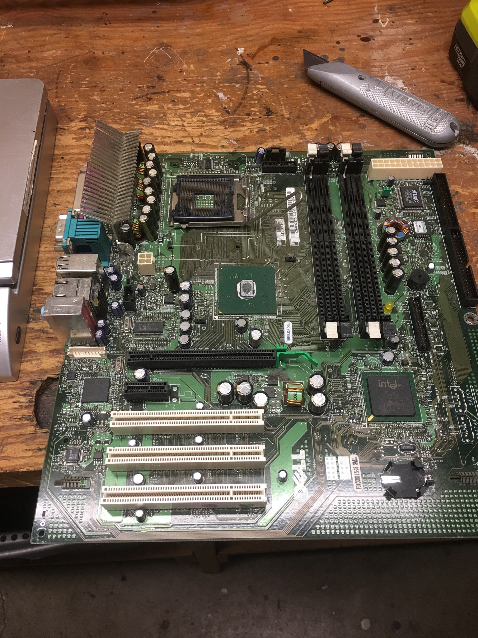

This is the very beginning of a diy page on the (stupidity of) breaking down a board to the raw pcb.
This will cover 99% of boards but I chose a damaged metal socket mobo for this.
Simply because when /I/ finish pulling it all down /I/ won't be loosing anything. I've got buyers in place for these various electronic components since I deal with enough volume of this stuff loose doing repairs.

This is the post where I list the steps in order in text with notes.
Step one
Of vital importance if using the rest of this yourself.
Remove any and all canister capacitors.
They contain oi. The oil is under pressure. The oil is toxic (though not deadly or even dangerously damaging on its own). It smells terrible and is harder to get rid of than skunk. And later when heat comes to play boiling pressurised oil flying at you is never fun!
Remove any and all heatsinks you can. Anything you can't targeted heat from a heat gun on 100• or less, get them off. All they do is slow the process.

Here's my board before
