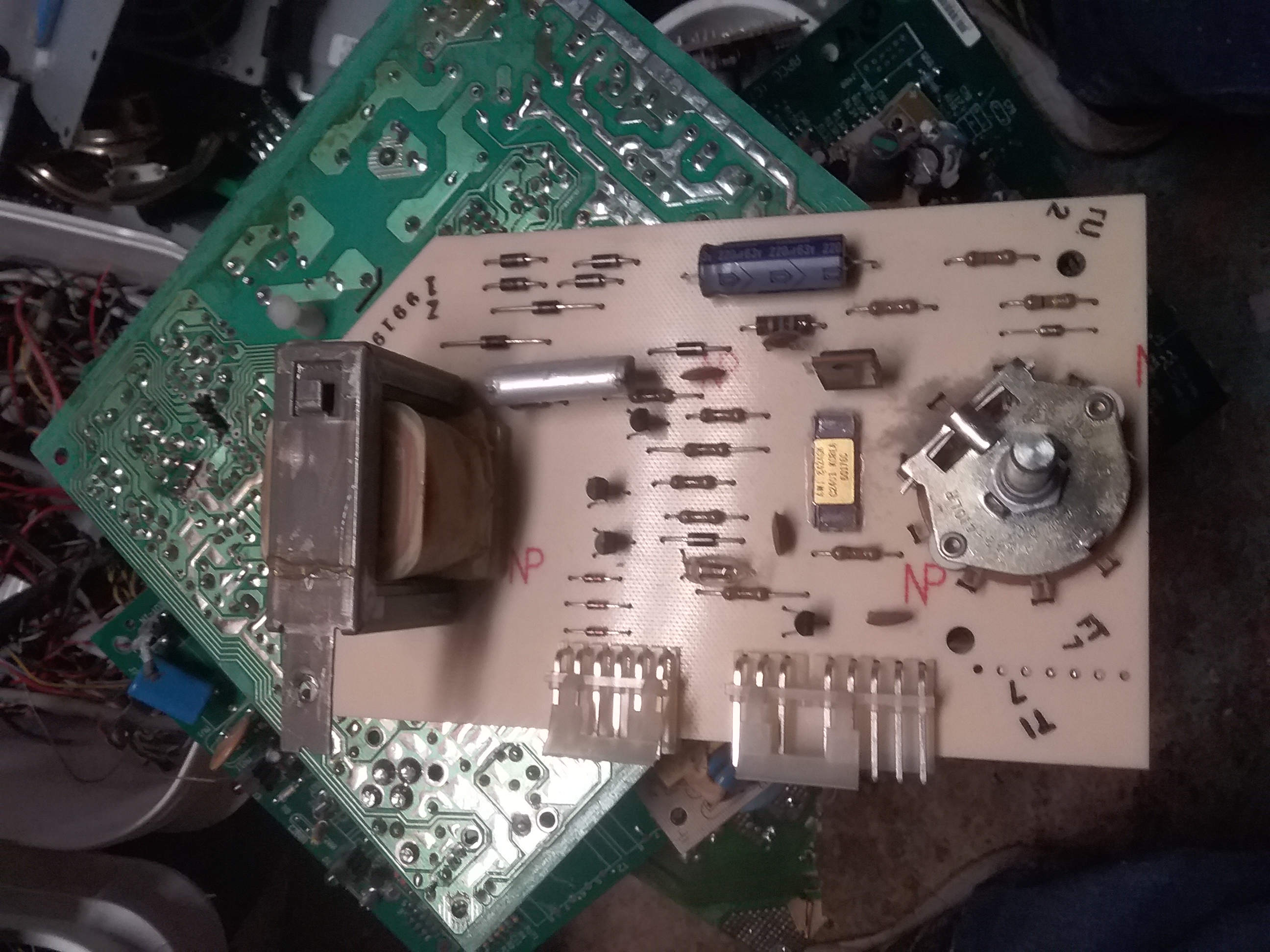

Here is an example of a board that is very out of the ordinary, a low grade board with a high grade chip from a very old dryer. It was bought as a gold cap chip board (only the one board), but it would otherwise go as a low or midgrade board with or without the chip.
Out of curiosity, what kind of dryer did it come out of? Like what brand and model?
I now wonder if home appliances from the 1980s with "high tech" features (such as humidity sensing, computerized controller, etc.) at the time could contain overlooked PM content that typically ends up in the shred pile.
