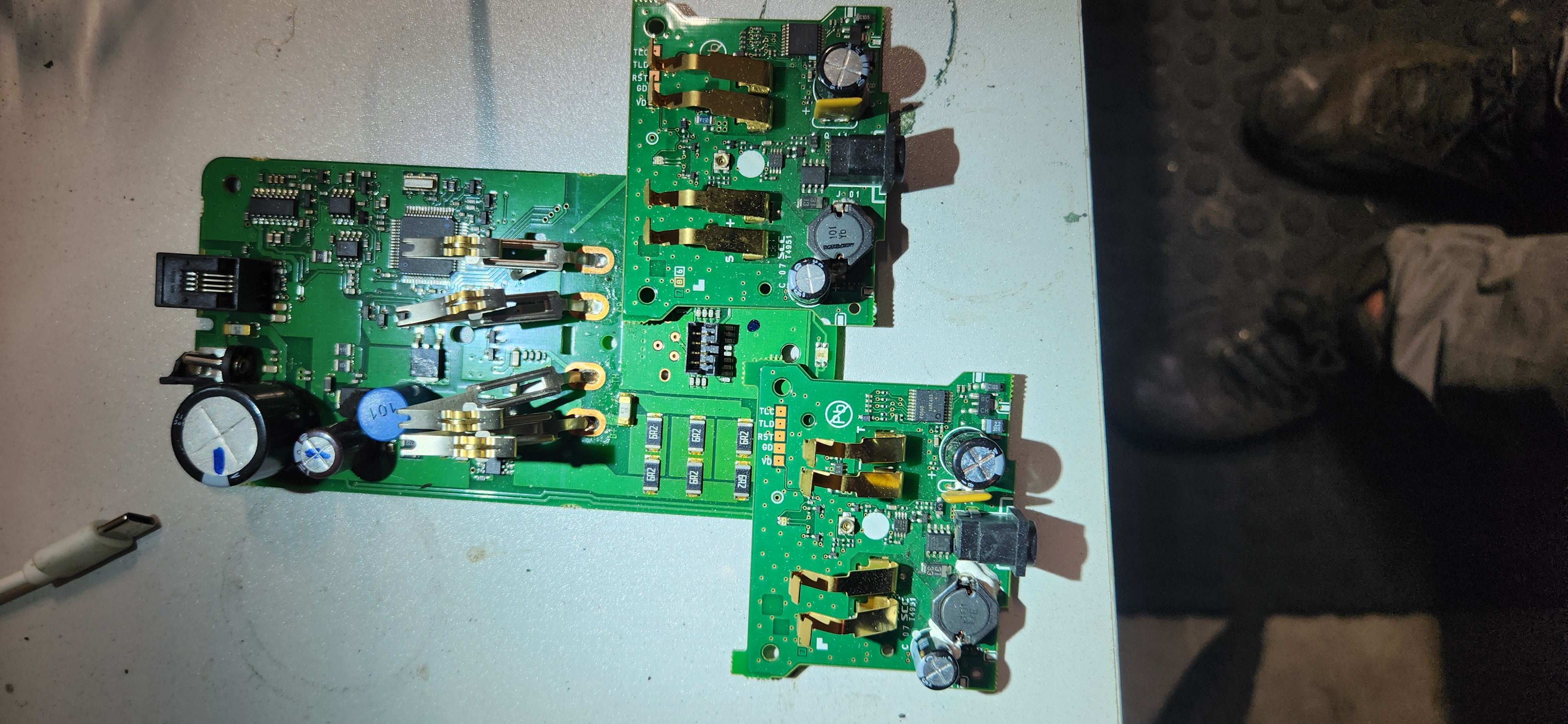

I have quite a few of these gold plated pins that are soldered onto different types of boards, usually for charging things like radios. I will post a picture of three boards together.My question is, should I remove the pins?And sell the pins and the board separately or just leave the pins on the board and sell it under a specific category? I just want to make sure i'm making the most money from my scrap. Also, i'm sure that I probably need to remove some of the components such as capacitors, if they aren't tantulum containing for example.

Generally, depopulating will make you more money but it usually makes for a worse hourly wage. If you have the time, then you might as well. I doubt that board would be anything other than high grade peripheral (if that, make sure to remove the capacitors). Maybe Telecom low/high if cleaned up.

To be clear, depopulating any boards is a complex issue and Boardsort generally discourages depopulation. Some categories on the price list are even labeled as over processed to let you know, it's not worth it. There are instances where other forum members have even done the work to weigh material before and after depopulation to get the values and end up with less money because the thing they took off was the thing making the larger board worth more.
That's not to say there's no case for depopulating, there are also members who have shared when to depopulate and how much to remove. If I remember correctly, Lostinlodos likes to depopulate the lowest grade boards and has methods to quickly remove all the components in a short amount of time. Then, I believe, he has buyers besides just Boardsort that he's able to get the most for all the different materials.
As far as these 3 boards I'm thinking high peripheral as is. I don't think think the large board will be affected by removing the pins as the gold plating is minimal. The two smaller ones, the gold appears to be on the entire pin and if you remove those I think you're looking at a possible drop to low peripheral and I don't know if you'd recover the better grade by removing anything else.

Not all gold pins, go for gold pins.
ALWAYS, ask questions first or ask the forum. We will not steer you in the wrong direction nor will Boardsort. BS wants to pay us the highest rate because its less effort and handling for them.
Half of those gold pins , are not accepted as gold pins. Lesser value

One further note, it has been advised in the past, trim any gold plated thing you send in so that there's minimal material without gold. For example the OP has some pins that are plated only at the contact point for whatever came into contact with the pins, if they were removed you would want to trim the silver parts off and the gold would go in gold plated pins.

Some examples of pins that aren't worth the $5.00 lb would be like IDE/ATA pins, the pins you see here that are spot plated at the contact point, or PCIe slot pins, mostly made of manganese brass or a tin; very seldom gold plated on integrated units nowadays.
