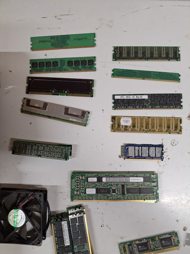

Good Morning- first time poster. Read as much as I can on sorting, binning, shipping, and evaluating.
Have approximately 15lbs of assorted Ram- single sided single chip, double sided single chip, double sided double chip, etc. Do these need to be sorted or kept separate ?
Also have heat spreaders- I see they're on different price/lb. Removing them is easy, and some are aluminum (which I recycle locally). Would doing so move it back into the straight ram category ?
Since many of these ram sticks were ECC/Registered or combinations of, they have a small chip on them. Separate these for ease of processing ?
2 massive SUN chips. So much history there... and CPUs.
Thank you in advance or guidance as I do not wish to make additional work for anyone.

Ram is sorted into three categories :
Gold or silver fingers
And ram with a heat shield.
As long as it has more than 2 chips it will still be a ram class (and not blank ram).

SO much easier than I feared.
Removal of heat shield/spreaders OK? Fortunately not too many of them.
PostPosted: Thu Nov 07, 2024 3:10 pm
Posts: 10568
If you can remove them without damaging the board and chips; yes.
Some are glued, some just use thermal paste: others use rivets.
Stick a tiny screwdriver between the shield and a chip. And scrap a bit out. If it’s grey gently pry the shield off.
If it’s yellow or white skip it.
As for rivits, with practice you can use a small nail or bolt cutter to snip through the circle at an angle, then pop the shield from the steel
