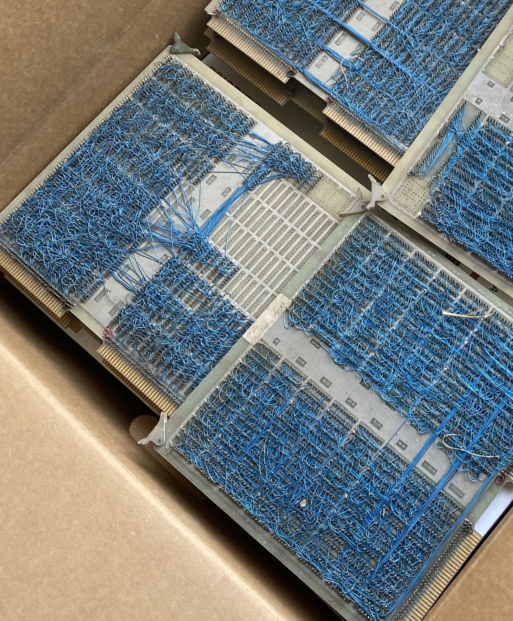

Does all the wire have to be removed from the pins on a wirewrap pinboard? Or can it be clipped close, rather than unwound by hand on each pin.?

At one point the rule was completely clean but Chris has responded more recently with “most”.
My take, and what I’ve sent in since covid, has been very closely cropped, were the exposed metal from the wire meets the sheath. But it was only two boards.
I also forwarded this for a final answer. Give him a day to get back.

uh-oh...
I think I may have messed up what I sent in if the wire is supposed to be trimmed. D: D: D:

Yours was fine. Close is all we ask. It is nearly impossible to remove it all.

That's good, cause I did nothing to them after I got them.
