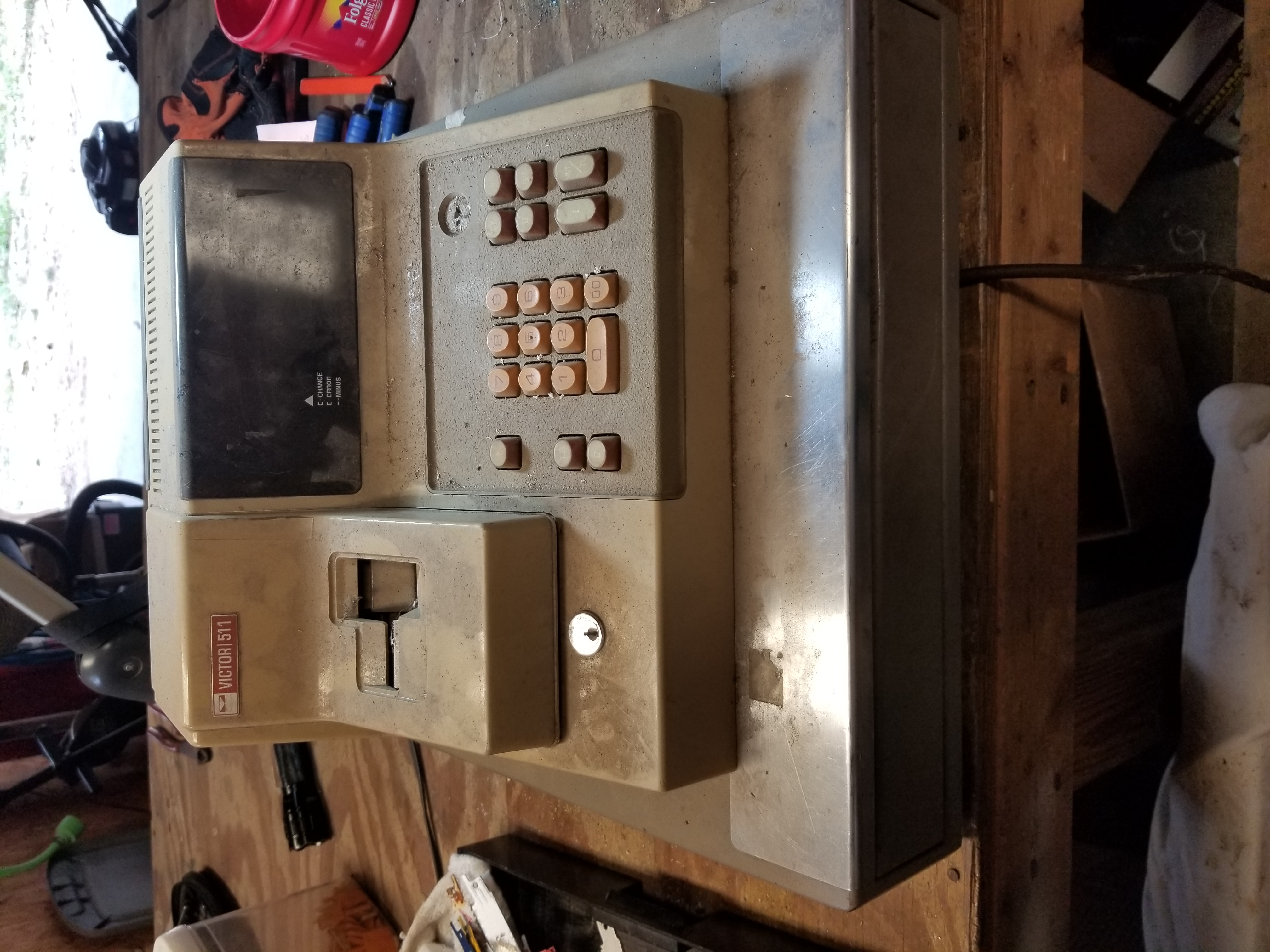

Register not working. Looks like eff mid 80s. May b interesting any thoughts. Thanks, BearScrapper
 Post subject: Re: What's it worth$$
PostPosted: Sun Sep 20, 2020 3:48 pm
Posts: 10496
I take it you had the key then. (Or hopefully we’re smart enough to use a juggler and not an expensive master key set).
I /believe/ the 500 series ran from early 70s to late 80s. With no clue which goes where date wise.
The mechanical ones up to the early 70s run in the low hundreds and I can find a few electro-mechanical ones of the era (70s) in that same range. Most working though.
I don’t think I’ve ever come across a 511. I had a 510 once from a sears that liquidated. And after some minor repairs it sold for $150. As a door stop my /guess/ would be around $50.
I’d pop the top though. See what’s inside. I’m curious like that.
I wouldn’t try to get this one fully working unless you have the expendables with it. Quick parts check shows things like ribbon etc is $50+!
$30 per spool, $15 springs, $40 fuse. Though the 511 generic ribbons seem to be under $10.
Why you’d spend $35 on a master key when you can cut an empty soda can for
Free I’ll never understand.

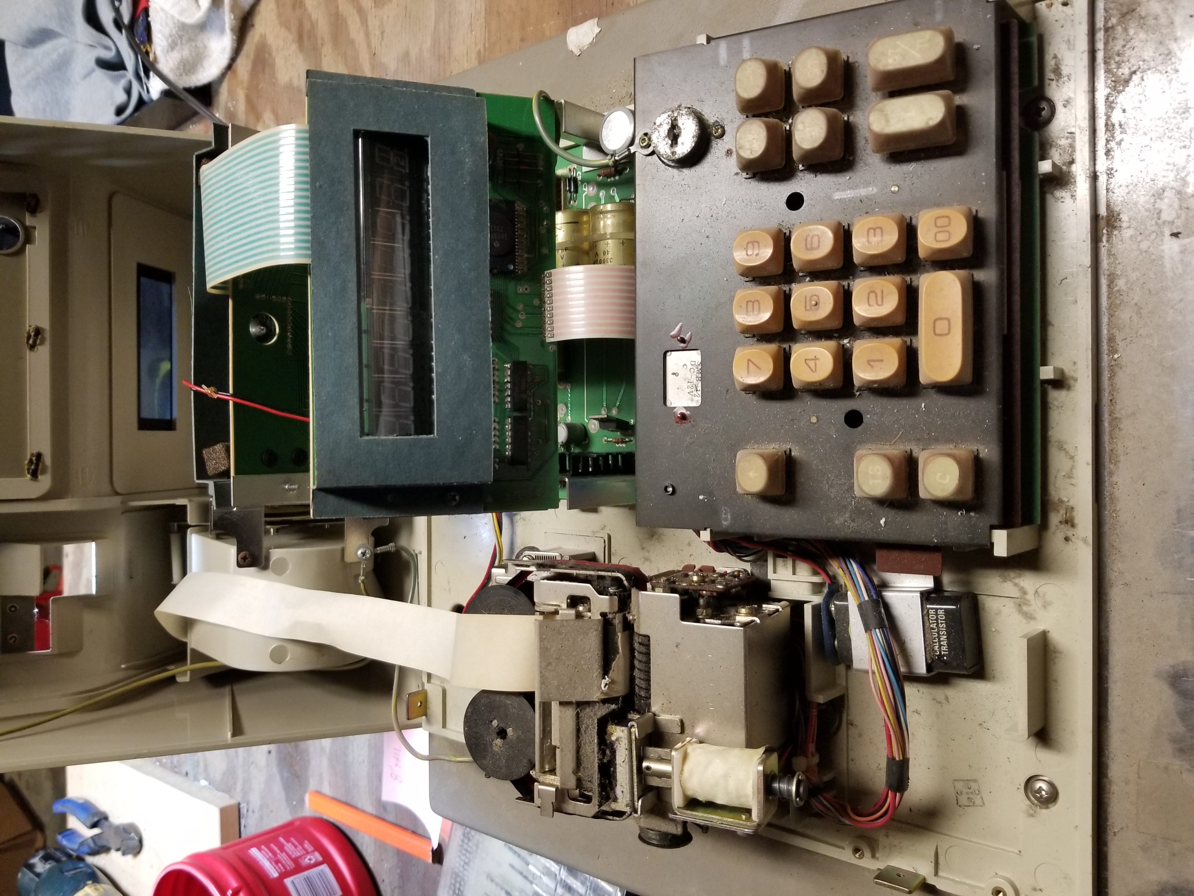

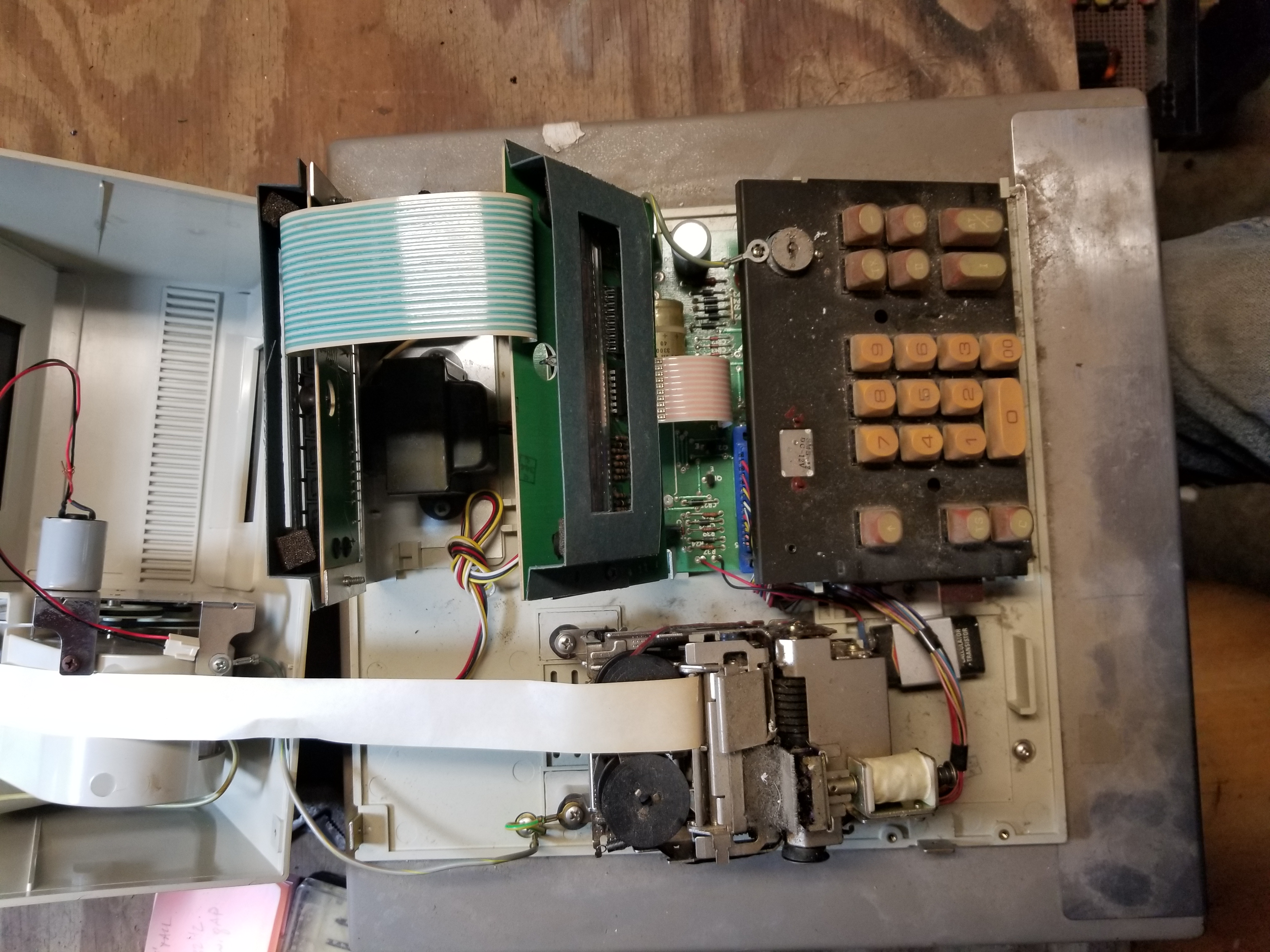

Not sure if this will help... but this is her inside.. pretty simple
PostPosted: Sun Sep 20, 2020 10:04 pm
Posts: 10496
Wow, a roll of tape for free! ;)
Looks like the ribbon is in there, and tape looks solid so spools are probably good.
You didn’t say so so I’ll assume the lift spring didn’t com flying out.
So it looks a lot like the 51e. 5 or 6 canister capacitors (I believe), a serial board. Guess I vacuum tube readout. Can’t tell from the image. My first guess fix wise after verifying capacitor and fusing health would be to bypass the key lockout. The electrical key socket. And try to turn it on.
From there grab a $5 electrical tester from $5 below or Dollar General etc and get to testing.
It a bit of a project but if your handy you could probably track the issue down. If you wanted to.
If not I’d clean it all up. Weigh it. Make pretty look at me photos and ebay that sucker. + shipping obviously.
Cash registers aren’t really my thing but I do play with EM accounting machines when I find them. Same kind of key lock to block out accessing stored value functions and the like. And tampering. Tax machines for CPAs that made the federal punch card ballots had them too. Peripheral f you can bypass it you can get a lever or push button switch for about $2. And replace the key point. You’ll want to do that anyway. But do keep the lock with it for a buyer.
Or again, sell it as is.
There’s unlikely anything major scrap wise unless the serial controller of a a ceramic gold cap. Unlikely on such a low feature model.

I don’t SEE any blown caps in the photos. So the transformer is my first point to look at.
