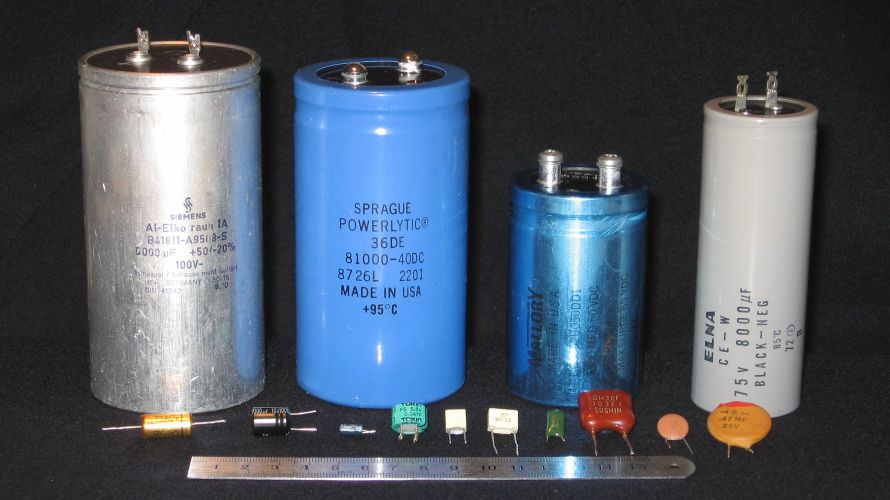

Hope it shows the difference between the different capacitors.

1) CMCs (aka mcc, solid state ceramic caps) Platnium, paladium for refining if your're really adventurous.

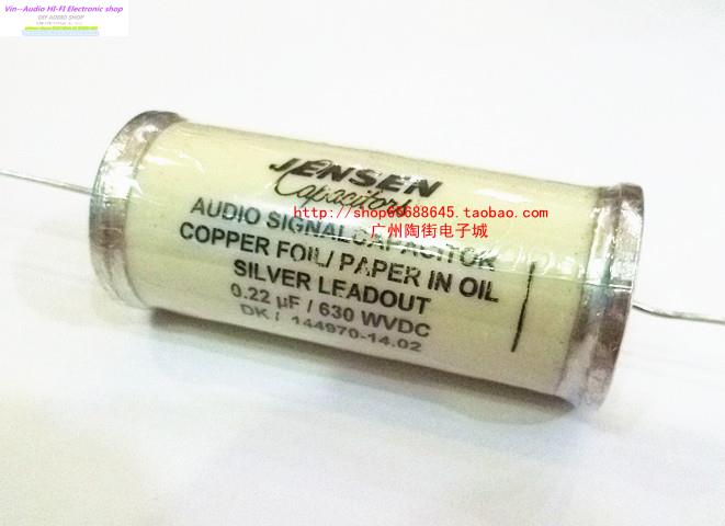

2) organic (copper) caps

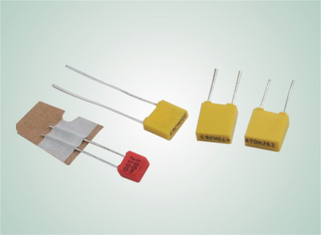

3) Canister caps. Top row, bottom row the left 3. all canisters. All 7 of those go in the aluminium class.
4 is also a copper cap, but in the silver recovery class. I'm looking to see if I still have any copper canister caps here.

What about those other ones in pic 3? I see those alot too
PostPosted: Sat Jan 23, 2016 1:28 pm
Posts: 10568
The canisters in 3 all go aluminium breakage
The rest are cbm.
