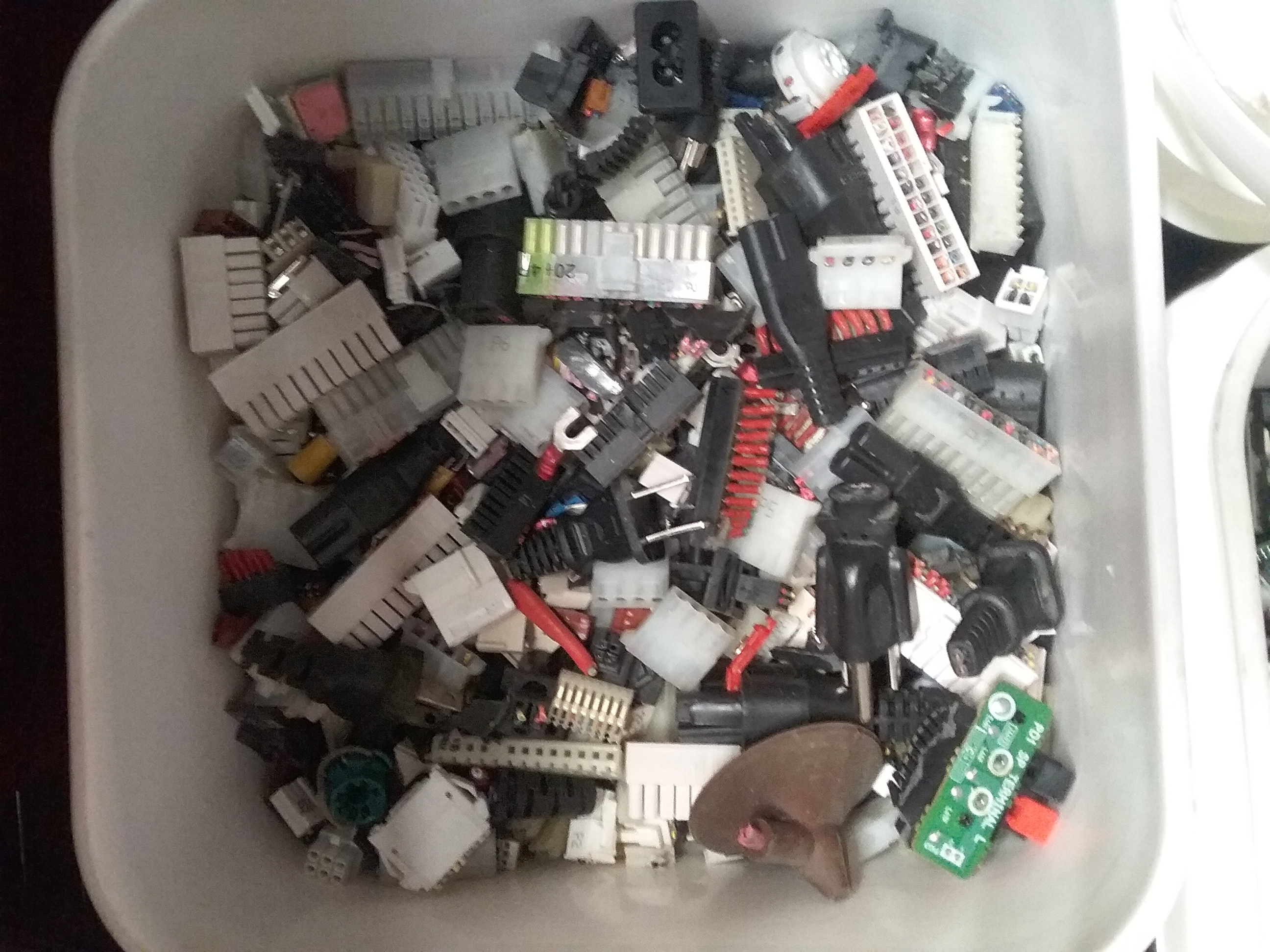

Any idea on what to do with the non gold hard rubber connector ends from power cords? Same with the plastic connectors from the power supply's that are not gold plated?
Thank you!

An image is attached.

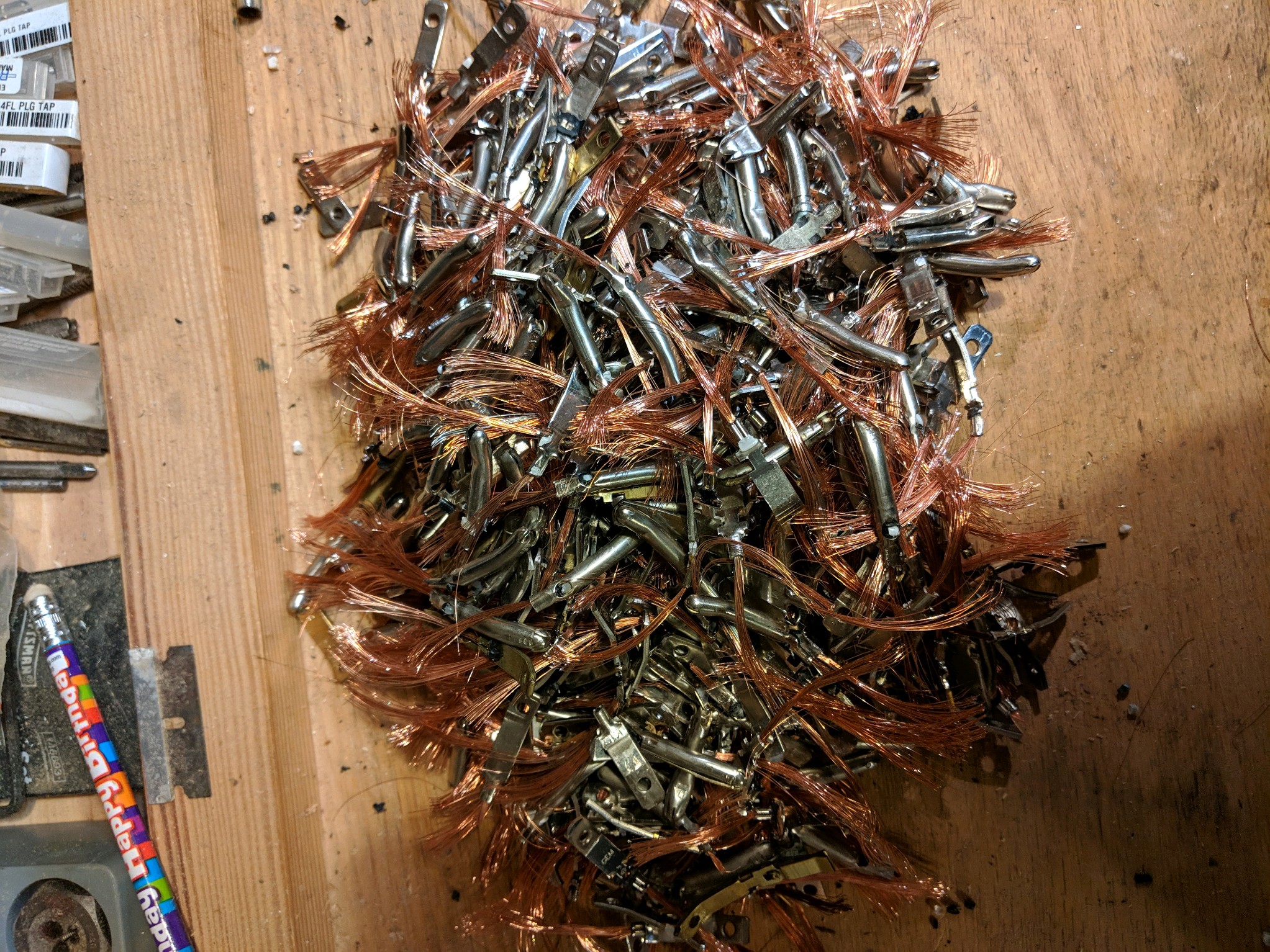

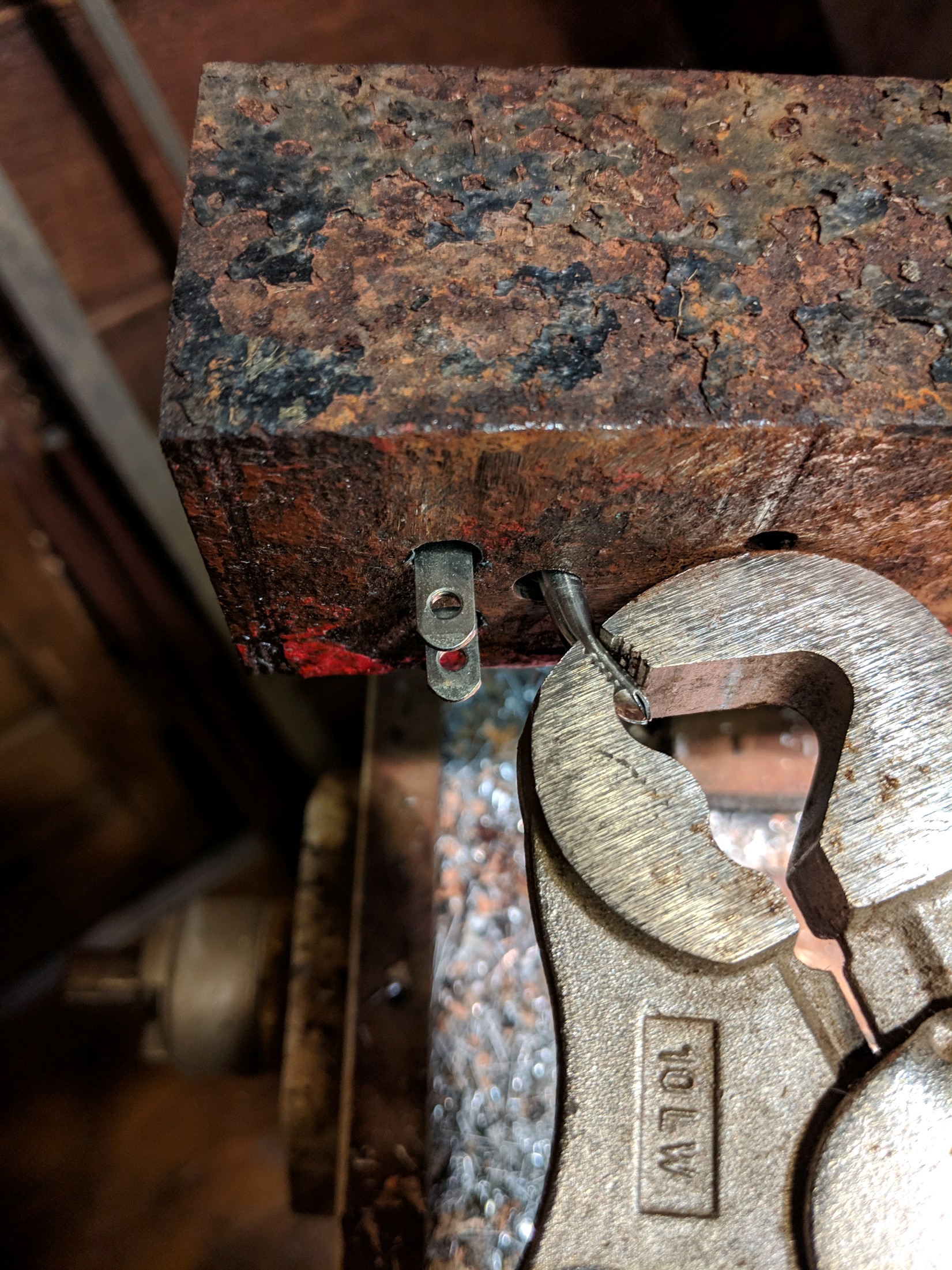

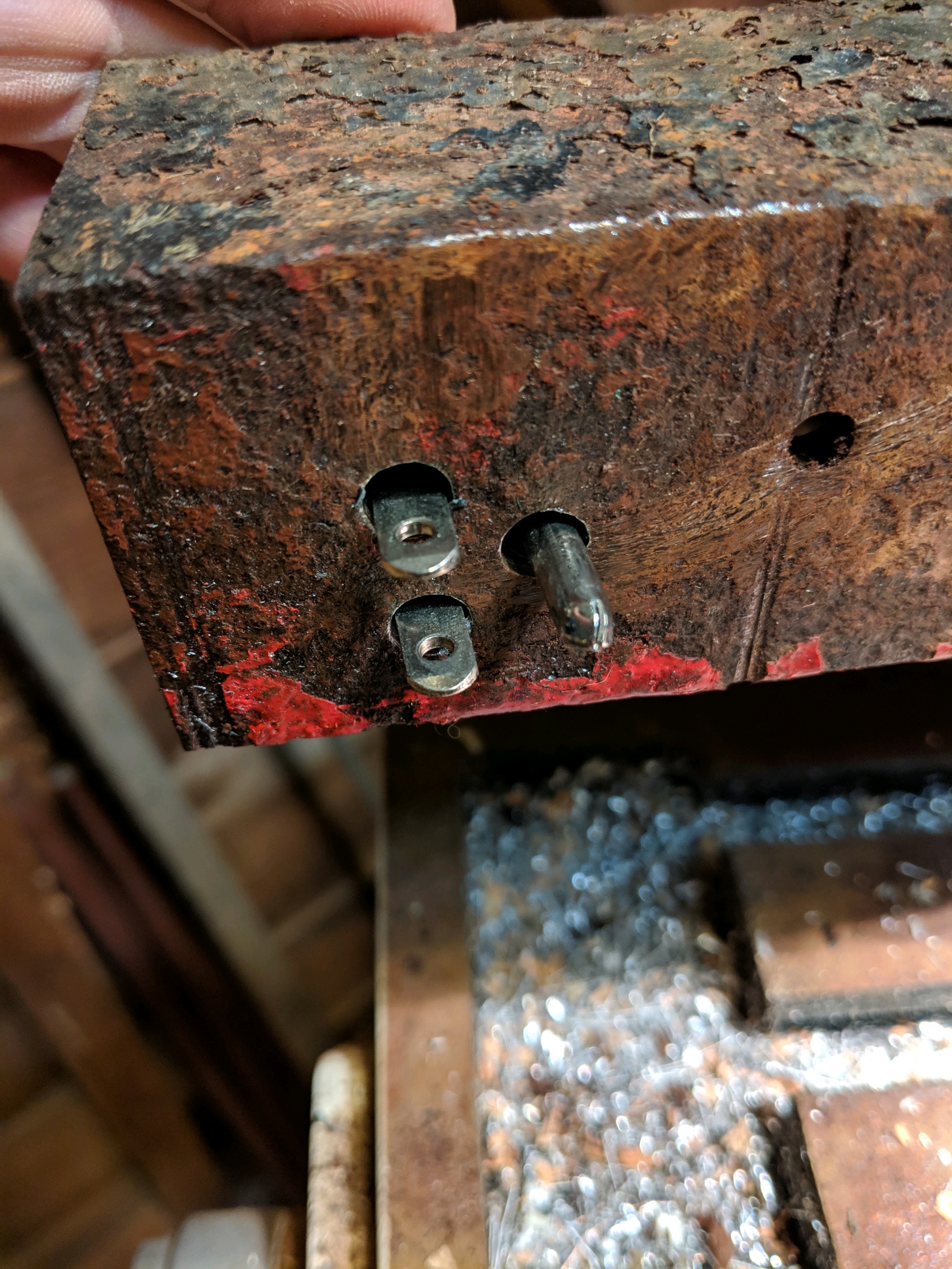

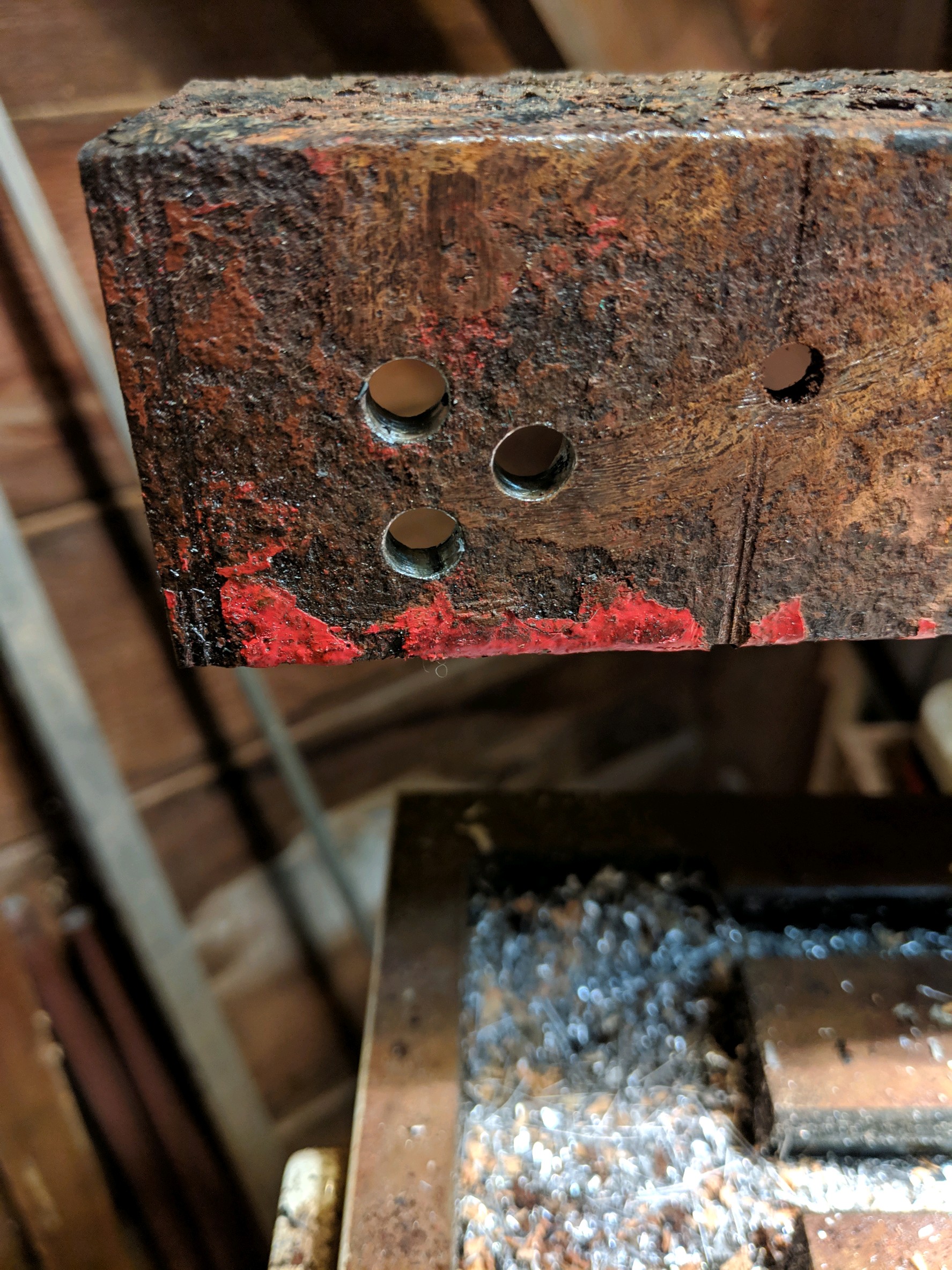

Here is my quick and dirty solution to remove the tabs from the connector on the male end of power cords.
3 holes in a piece of old angle iron
insert the plug end
Rotate the tabs out with vice grips
Produce a pile of brass and copper
The copper wire segments inside the plug usually pull out with the tab.
