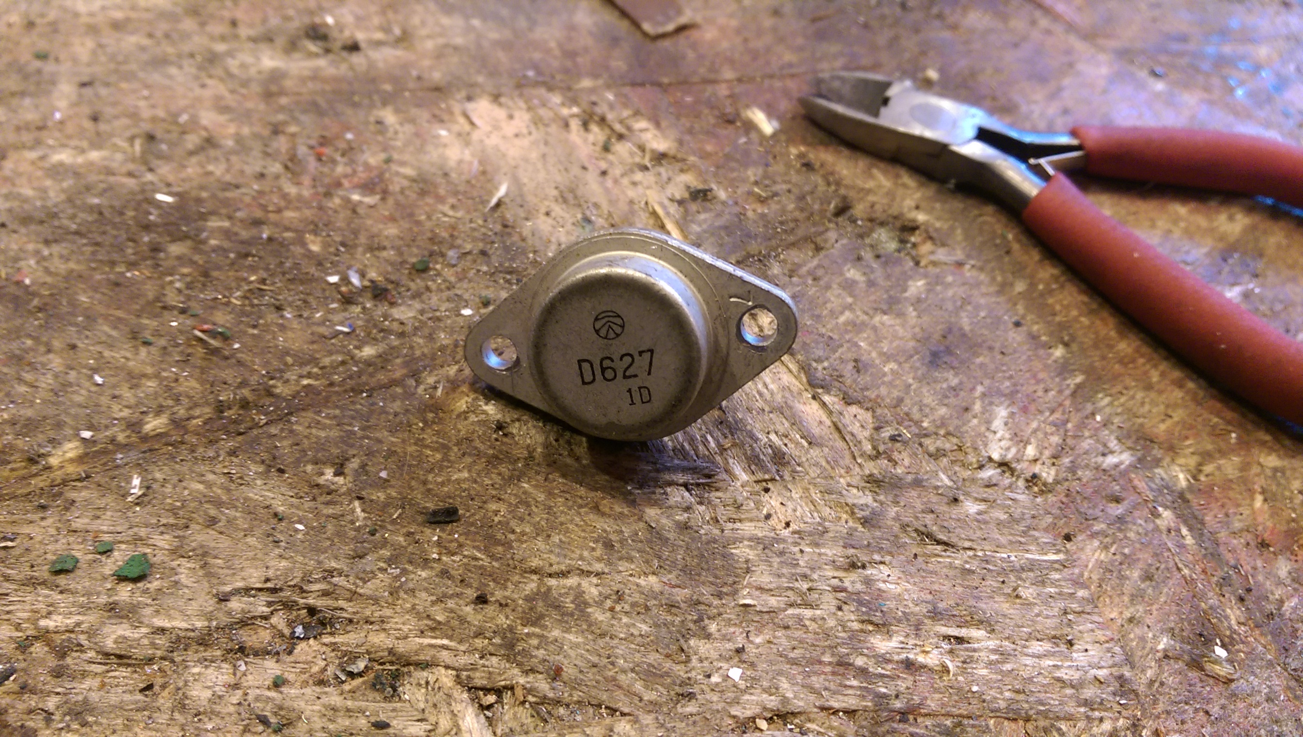

Ive accumulated some lowgrade and midgrade. Looking through it i noticed a missed some ic chips and some transistors.
What else would it be worth grabbing? Large caps, as in the pic? Some silvery things? What about the steel heatsinks or other large steel pieces. Is it better to keep it on or to the steel pile?
Heres an example of a board- what else should i grab?
Also an ID pic please.

So the pic i have in the op is a can transistor?
