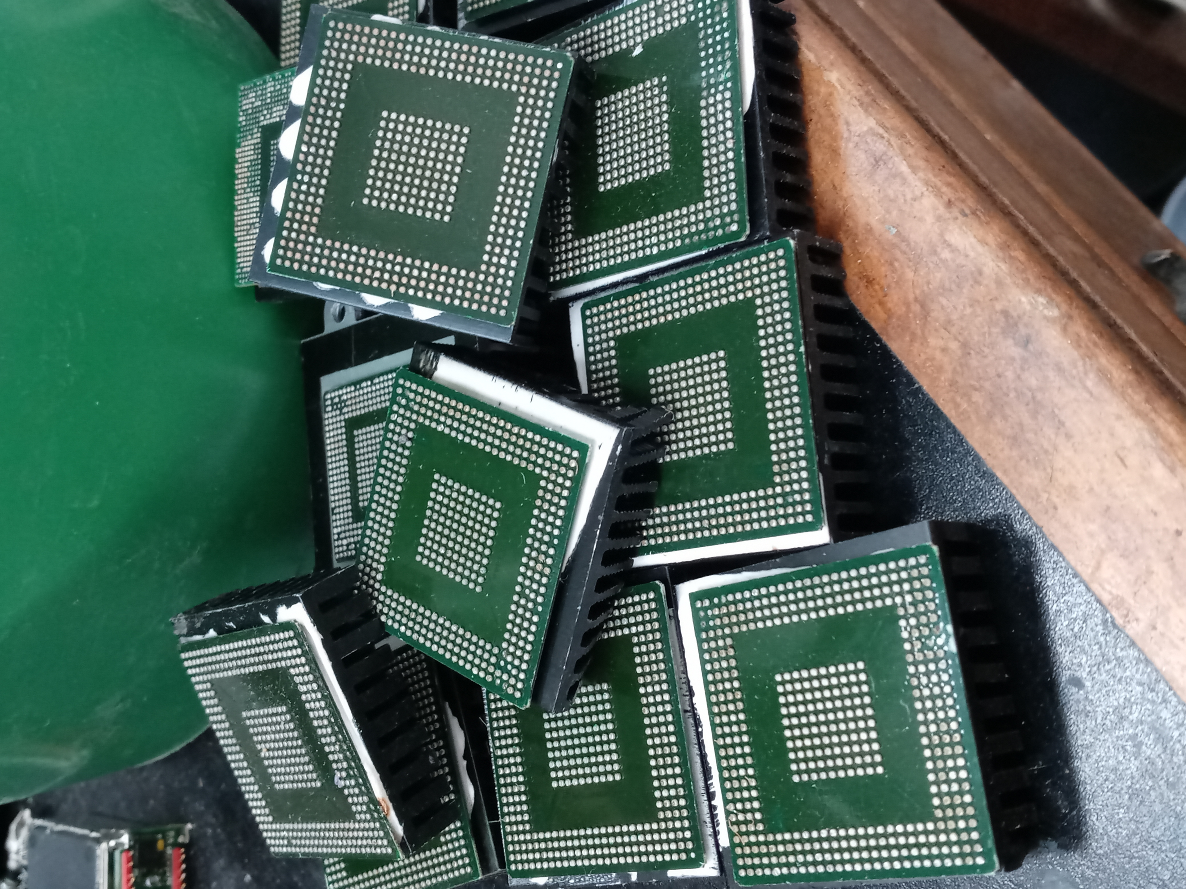

I'm starting to notice I have an accumulation of flat chips with the heatsink still attached what do you think I should do with them
PostPosted: Sun Jun 20, 2021 7:25 pm
Posts: 10568
Ideally you remove the heatsink since as is they’re somewhere between dirty aluminium and midgrade.

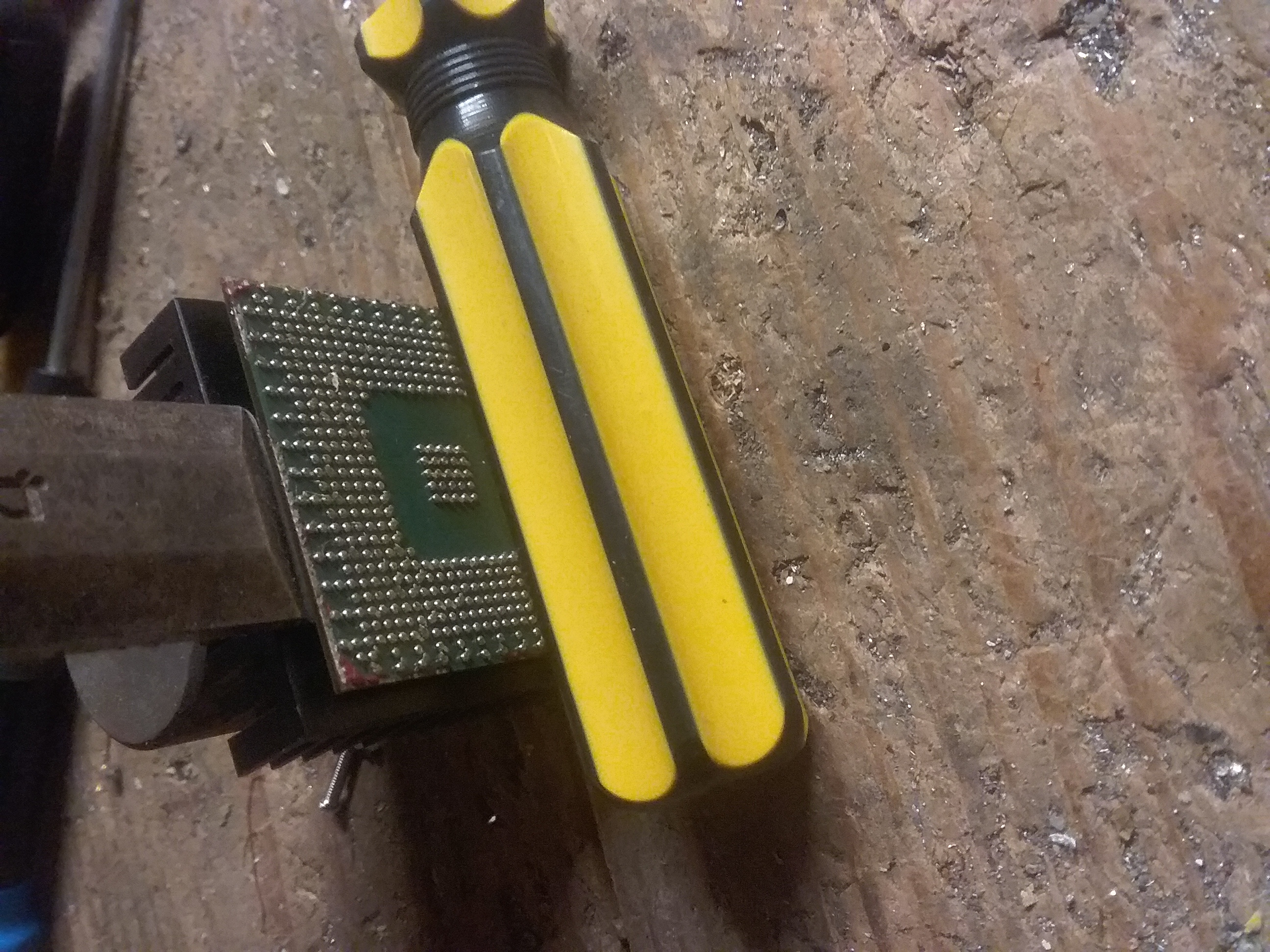

PostPosted: Sun Jun 20, 2021 8:42 pm
Posts: 557
You can probably take a chisel and put it inbetween the chip and heatsink and hit it with a hammer. It would work best if you use a wood chisel and put the flat portion of the chisel against the heatsink and the angled portion by the chip.
I will try to take pictures later.

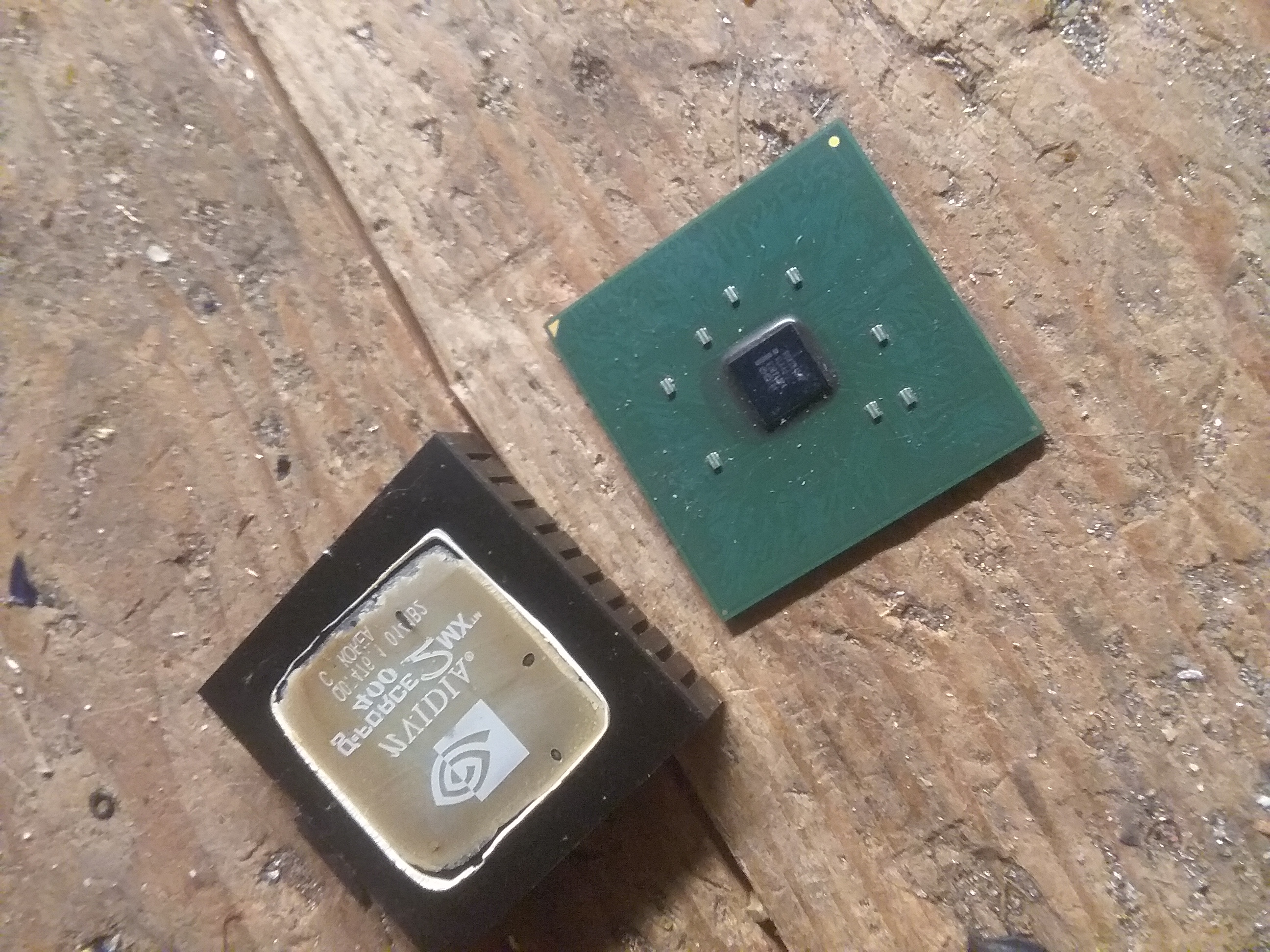

PostPosted: Mon Jun 21, 2021 10:12 pm
Posts: 557
Pictures added.
I realize that the chip and the heatsink do not match up, it is for show only because I don't currently have a chip attached to a heatsink.
PostPosted: Tue Jun 22, 2021 8:53 pm
Joined: Fri Dec 22, 2017 1:27 pm
Posts: 83
Best way I found to remove them is with a heat gun. Every time I try to get the stuck on heat sink off the secondary processor on the mother board I end up tearing the chip off the board so now I just heat the top a little and it usually comes right off. It will work the same with those cpu's then you will get the better price.
