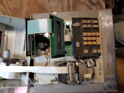

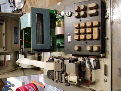

Not sure if this will help... but this is her inside.. pretty simple

Wow, a roll of tape for free! ;)
Looks like the ribbon is in there, and tape looks solid so spools are probably good.
You didn’t say so so I’ll assume the lift spring didn’t com flying out.
So it looks a lot like the 51e. 5 or 6 canister capacitors (I believe), a serial board. Guess I vacuum tube readout. Can’t tell from the image. My first guess fix wise after verifying capacitor and fusing health would be to bypass the key lockout. The electrical key socket. And try to turn it on.
From there grab a $5 electrical tester from $5 below or Dollar General etc and get to testing.
It a bit of a project but if your handy you could probably track the issue down. If you wanted to.
If not I’d clean it all up. Weigh it. Make pretty look at me photos and ebay that sucker. + shipping obviously.
Cash registers aren’t really my thing but I do play with EM accounting machines when I find them. Same kind of key lock to block out accessing stored value functions and the like. And tampering. Tax machines for CPAs that made the federal punch card ballots had them too. Peripheral f you can bypass it you can get a lever or push button switch for about $2. And replace the key point. You’ll want to do that anyway. But do keep the lock with it for a buyer.
Or again, sell it as is.
There’s unlikely anything major scrap wise unless the serial controller of a a ceramic gold cap. Unlikely on such a low feature model.

Fortunately these, like all EM calculators, are very forward in their workings.
There are two machines here. You have a 1968 certified CPM calculator. And an electrically triggered lock vault.
You have the basic set of ICs for mathematical function. Everything beyond those ICs is purely getting the correct energy to the correct spot at the correct frequency, and in the correct offset for spikes.
Head over to good will or savers, Salvation Army. Etc.
Find a 99 cent - $1.99 old fashioned can opener or the like. Low end mechanical kitchen appliances. Look for the closest you can get to the correct wattage and buy that appliance. (Test it for free while there first, obviously. Just needs to turn on/power up, not work)
Steel the transformer from it and swap it out.
I don’t SEE any blown caps in the photos. So the transformer is my first point to look at.
Sill not working? Any chance you have a wall or under stove convection oven that has a keep warm function?
Good
Remove the boards from the casing
Turn on the oven to 250• and wait 10 minutes or so
Now Set the oven to keep warm and open the door. Wait a few minutes (3-5) to let it both cool off to the keep warm temp.
Doing this in this order is vital.
Place the boards on the bare track with a steel cookie sheet on the rack below it. Partly close the door to the mid-way point.
After 30 minutes gently take her boards out and let cool go an hour!
Do NOT drop or bang them!
That’s typically warm enough to SOFTEN the solder back around pins without melting/burning anything g.
The cooling time helps keep tight seals without gaps from air or shrinkage.
Put it back together and try again.
