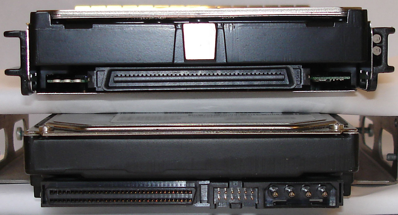

How to identify a SATA board from a non-SATA board?
Simple. A SATA board does not have pins in its connector but instead has little gold fingered ridges on a plastic lip. Once you see the connector you will always know it. They are very recognizable.
PICTURE OF A SATA CONNECTOR
PICTURES NON-SATA (IDE and SCSI) CONNECTORS
IDE
SCSI
So in summary, if it is a SATA hard drive board it is a Low Grade Hard Drive Board.
If it is NOT a SATA hard drive board it is a HIgh Grade Hard Drive Board.
Easy as that.
