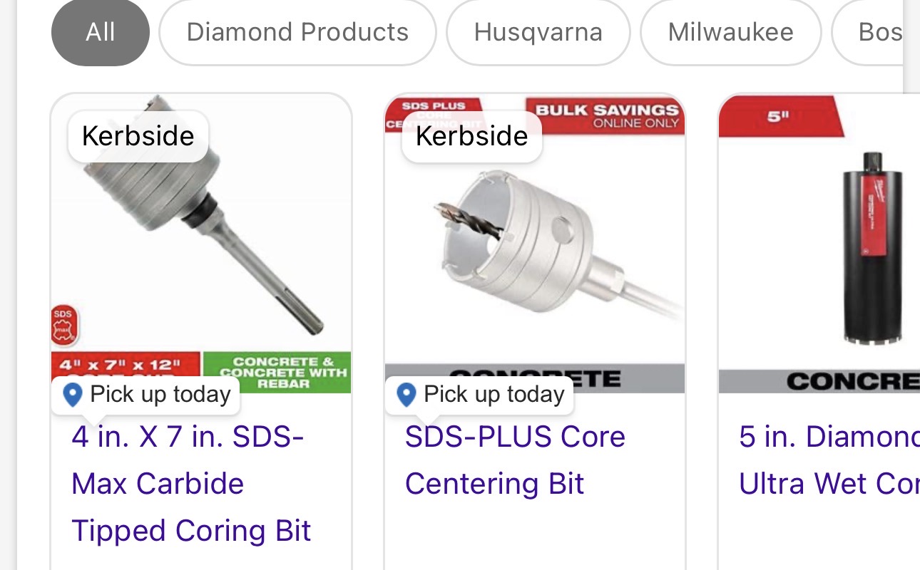

I know this is an old post, but any chance you could post a picture or a link to said steel coring set? I searched online and came up with only drill bits or actual apple corers.
PostPosted: Fri Jun 27, 2025 8:56 pm
Posts: 10568
You want something like this. They come with and without a central drill bit.
If you can’t find a bit-less cone you can use bolt cutter or saw bit to cut the bit flush to the cone.
You won’t be drilling, just line it up and smack the end with a hammer.
