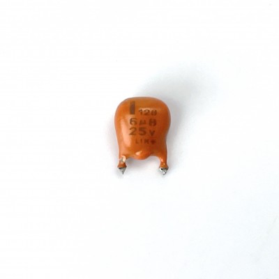

I was sorting my Tantalum dip capacitors and I noticed these are not magnetic like other tantalum dip capacitors. Any idea what type these are? When I was pulling them, I easily thought tantalum but I guess not. got 150+ of these.
Thanks for your help

Btw these are SIP, not DIP. There’s only one row of pins (I know you could say two rows one column or one row two column but...)
My /guess/ would be organic polymer but can’t be positive on that.
Best shot is OPP SAL.
Aluminium.

bust it open it may be a MLCC. If it is non magnetic and a MLCC its a good one. But you need a few hundred more to amount to anything.
